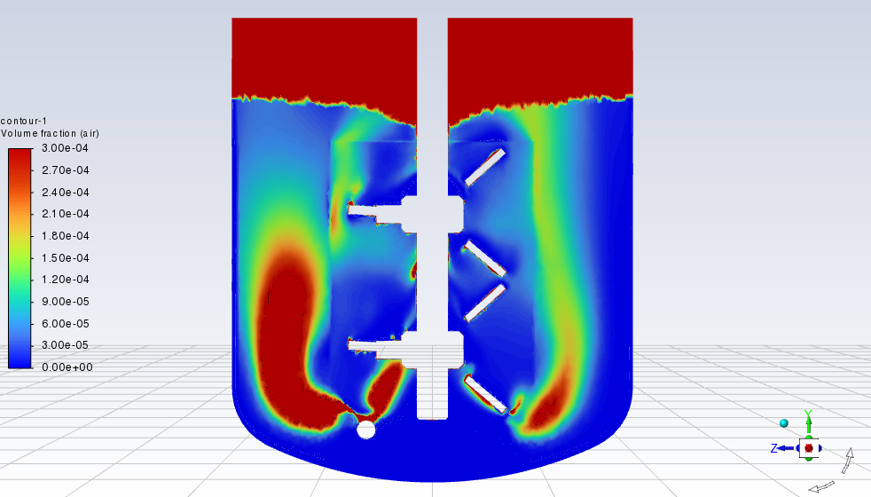

I am modeling a stirred bioreactor and am using MRF for modeling the impeller rotation. When I plot the air volume fraction contour, there is a discontinuity almost at the interface of the two regions and it looks like this;

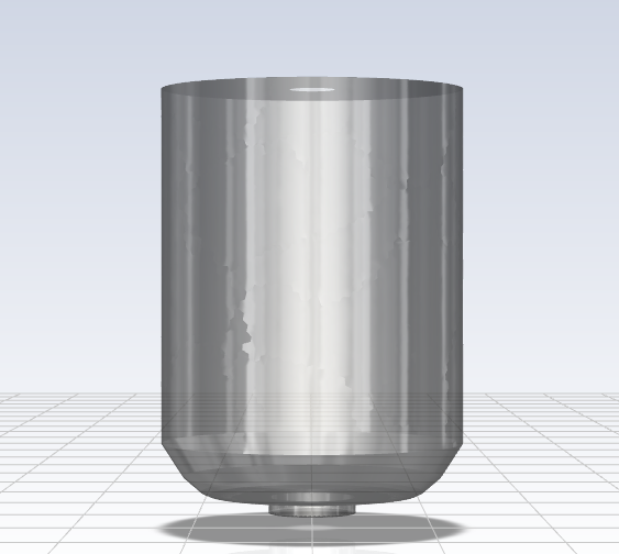

Thank you so much for your answer. The domain is a tank with an impeller rotating at 250 rpm. There is a sparger at the bottom that injects single-size bubbles into the domain. The rotational region holds the impeller blades and the rest of the tank is stationary region. I use MRF(Frame motion) technique for setting up this problem. You can see the rotational region in picture below;
As you can see, the rotational MRF region's interface is exactly at the same place that the discontinuity in the contour takes place.

AdministratorHello Could you refine the mesh further, especially across the interface between your stationary and rotating regions? I suspect this is an artifact of either convergence or mesh.

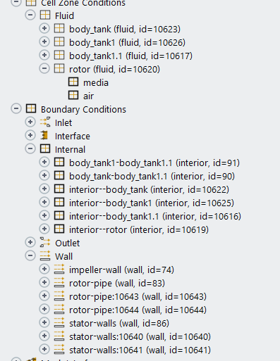

I receive a face-handedness error and my interfaces change to walls instead of remaining interfaces. It seems that although I have defined the interfaces as internals, they are somehow considered as walls. I can refine the mesh at those interfaces, but I don't think this problem has much to do with mesh refinement. As you can see i the first contours I attached in my question, the flow seems to crash a wall around the interface and it is not passing through the interface.

Also, the discontinuity in the air volume fraction exists in both MRF and SM. Why is this happening?
These two seem two separate questions but they can still have something to do with each other! Since, if the solution is considering a wall a the interface, then the reason for why this discontinuity is happening becomes clear. But on the other hand, when I check the boundary condition of the interface in the MRF simulation, they are defined as internals and not walls! Which means there should be something wrong with mesh?

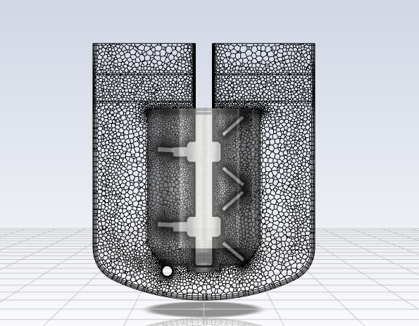

The discontinuity could be mesh related, and I do wonder why the cell size is so small at the top of the mrf zone. Equally, convergence may be an issue, have you altered any of the UR, Courant number/time scale values?

Also, you have asked: "and I do wonder why the cell size is so small at the top of the mrf zone", I just set the size at the top surface of mrf region smaller as it is close to the gas/liquid interface at the top pf the reactor. Do you think that might cause a problem?

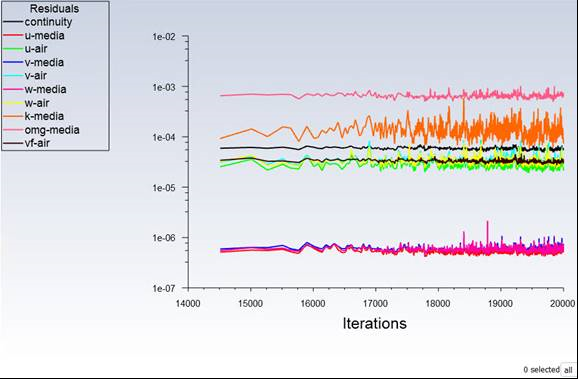

The mass conservation seems to be acceptable in this case. Also, the residuals look like this by the end of the MRF simulation;
Kind regards Roya

Forum ModeratorThe size isn't a problem but I'd probably have not included the free surface in the geometry & used a register to patch the liquid. The aim of simulation is to avoid messing another step of the model up by doing something earlier in the process: there's a reason we plan simulation runs.

SubscriberDear Rob I am not modeling the interface through mesh. That volume in the middle that you see is a volume that I put there to actually get a better prediction of the vortexes at the top interface. I use adapt/patch to model the free surface at the top. But the top of my rotational region is close to the free surface, so I used a smaller grid size at that interface as well as defining a body of influence around the liquid/air free surface for capturing the top surface more accurately.
Also, as I was using the direct method of mrf-to-sliding mesh (without one to one pairing), I noticed that as I change my model from MRF to SM, some new walls are formed at the interface of rotational-stationary region. These walls do not appear in the list of the boundaries, but they appear in the list of the zones in the contour and mesh windows.
And if I plot these walls, they appear exactly to be at the interface of rotational-stationary region. Is this logical or is that a mistake? How can I fix this?

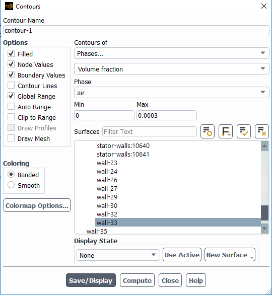

The walls I mentioned in the comment above only exist in the list. They can't be plotted. The picture given above is actually the interfaces, and not the newly created walls.

Forum ModeratorThose walls are normal. In your case they shouldn't do anything, they're for cases where the interface surface pair don't fully overlap. Do you see that any other fields have a discontinuity at the interface surface?
