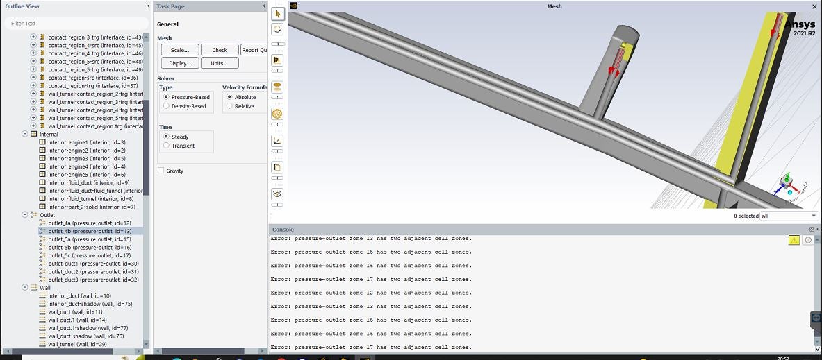

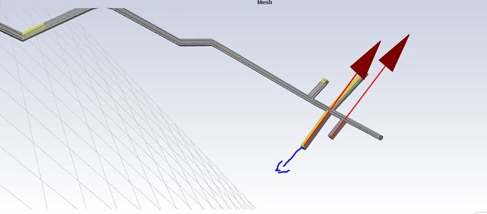

SubscriberHeloo i really curious i have model but the direction vector of the outlet is wrong how
i overcome this (The vector is moving back to the pipe instead of going out). I Imported my model to 3d in AutoCAD as slice material for the pipe the inlet is completely inside the tunnel (the case is the pipe has to suction the air from the tunnel and blowing out again) what should i do, the boundary condition is kinda confusing )

Forum ModeratorÂ
What boundary type did you pick? If it’s a velocity inlet (for an outlet) the image vector will still point into the domain. It’s to indicate the boundary rather than show the flow direction (inlets to tend to flow into the domain though). I'd check the mesh, with only one indicator arrow that could point to a very low cell resolution.Â

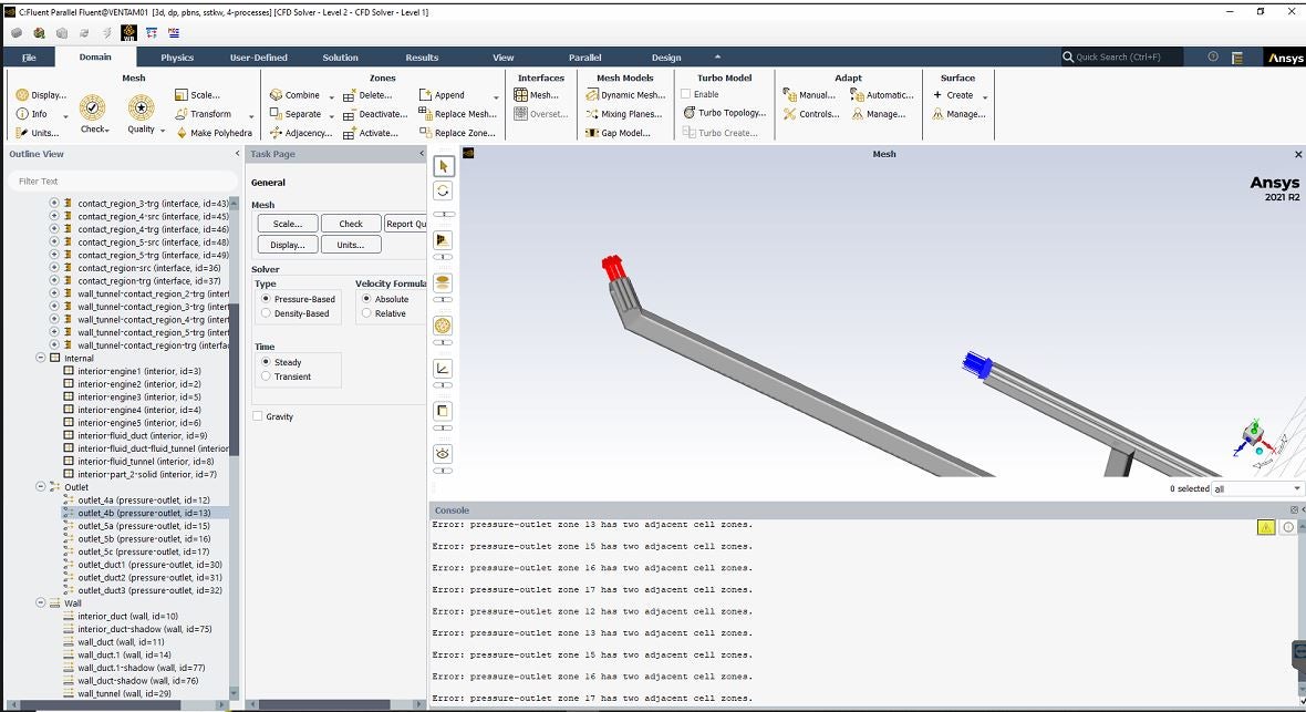

June 20, 2023 at 1:10 pm
Rob
Forum ModeratorAn outlet will point out of the domain, please post a screen shot of the boundary condition panel.Â
June 20, 2023 at 1:54 pm
June 20, 2023 at 2:18 pm
Rob
Forum ModeratorYou need to very carefully look at your boundary conditions. You cannot have an outlet (or inlet or any other external boundary type) inside the domain. The errors will prevent the model from running.Â
When you built the mesh you labelled some surfaces as "outlet" and that carries the type over to Fluent.Â
June 20, 2023 at 2:24 pm
Agung Limowa
Subscriberoh i see now, that's why my fluent always floating point Exceeded and divergence, i will find a solution to modify the boundary thankyou
June 20, 2023 at 2:26 pm
Rob
Forum ModeratorAssuming it's supposed to be interior either fix in Meshing (set the boundary type) or change into a wall (Fluent will create a wall & wall:shadow pair), then turn that wall into an interior.Â

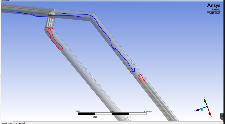

June 21, 2023 at 9:12 am
June 21, 2023 at 10:43 am
Rob
Forum ModeratorDo you also want air flowing in the ducts? If so, you can't use a velocity or pressure boundary.Â

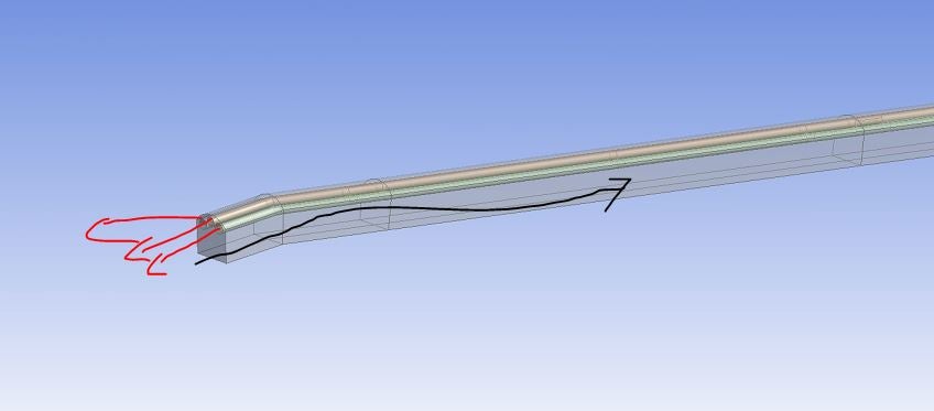

June 21, 2023 at 1:03 pm
Agung Limowa

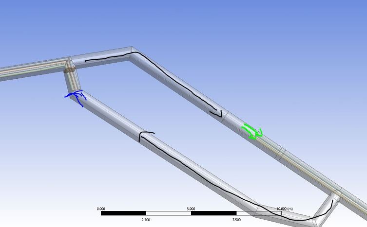

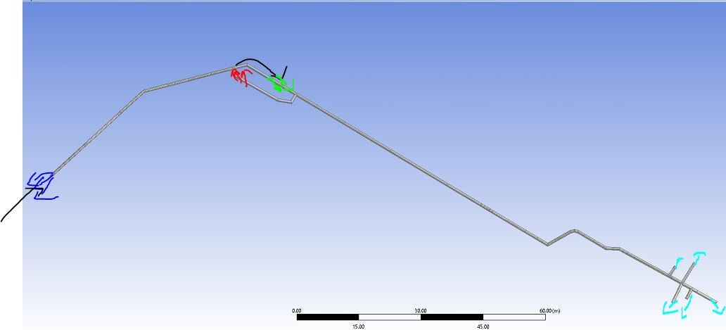

Subscriberyes it is a duct and tunnel case, and the duct have fans in it, so maybe to be clear here is my scenario
So, The air is flowing from the tunnel inlet (black arrow) all the way to the back of the arrow, and from the middle the air is suction to that back and have outlet there (tosca arrow) and all the air is inside the tunnel is suction from red arrow and finally ended at the portal (blue arrow)
Do you have an idea for the boundary condition i've set the tosca arrow as an outler, a green arrow as an inlet and the red arrow as interior and finnaly blue arrow as an outlet. Is this correct, bacuse i always have an error on my simulation either floating point, turbulence viscosity limited, Divergence in AMG Solver and so on.
June 21, 2023 at 1:45 pm
Rob
Forum ModeratorOK. For the external boundaries (tunnel ends) you need pressure or velocity, the choice will depend on what you know.
For the ducts it's a little more complicated. Do you need to model flow in the duct, or do you just need to understand the effect of the duct flow on the larger tunnel? Have a look at fan boundary conditions and FIX cell zone conditions, or neglect the inside of the ducts and use velocity boundaries with +/- components to suit.Â

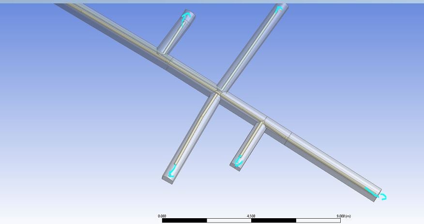

SubscriberHi, it's me again i have the question about the Inlet and outlet inside the domain, the problem is i want to set the parameter there what should i do the if in this case of problem ?
June 22, 2023 at 2:14 pm
Rob
Forum ModeratorYou want to set the flow speed in the duct?Â
The inlet/outlet boundaries CANNOT have cells on both sides. So, the duct either needs a fan boundary, FIX/source cell zone conditions or to be a void. For the latter the ends are then, by definition, on the outside as there is a hole where the duct ought to be.Â
