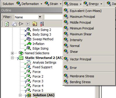

I've simulated my model and I would like to see the direction of equivalent stress.
How can I do that?

Equivalent stress is a scalar, it doesn't have a direction.
You want in plot Vector Principal Stress.

SubscriberHow can that be done?
