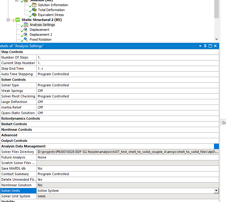

You can also try changing the unit system, as I find that can help solve the model if any of the numbers are particualy big or small, it can cause issues.
