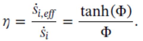

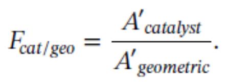

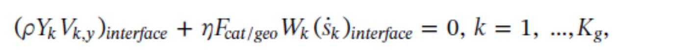

      In literature, the author considered diffusion limitation by modifying species boundary equation on wash-coat-fluid interface as follows:

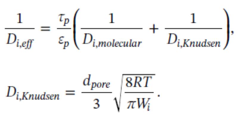

      I put all parameters in this equation as follows:
      . My question is:
      According to these equations, the author just modified the species equation on interface with an effectiveness factor, does it mean this is still a one-dimensional problem and species and temperature contour still can not be obtained from this model? However, the author also calculated catalytic surface area per wash-coat volume. By doing this, did the author just turn the surface reactions into volume reactions in fluent, which makes this a two-dimensional case?
      This confuses me a lot. Can anybody help?

      Are you sure that he resolved the porous media?
    • Weiqiang Liu
      my opinion is he did not resolve porous media. But I am not very sure. On one hand, seems like he just calculated a lumped effectiveness factor to consider internal diffusion. On the other hand, he used catalytic surface per wash-coat volume, I wonder did he turn the surface reactions into volume reactions.
