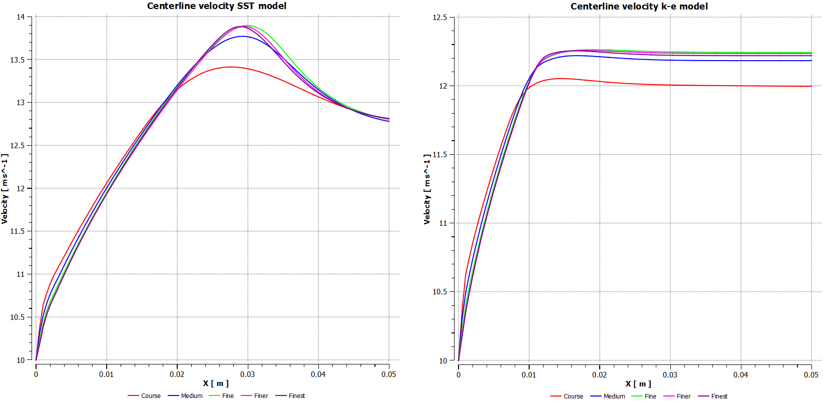

During a simulation of a 3D tube with square cross-section using two different viscous models in steady state I noticed a big difference in the resulting centerline velocity. Please see the below images, which show the solution to the problem for different mesh sizes (resulting from a mesh convergence study).

The developing boundary layer is effectively a flat-plate kind until it becomes fully developed. If you calculated Re based on the entrance length, the value (~200,000) is less than the transition Re for the flat plate. So, effectively, high-Re models are being used to model a low-Re flow, which they are not designed to do, and its probably just fortuitous that one of the models is doing less of a bad job than the other model. One possible solution is to employ a transition turbulence model. Please do consider the mesh resolution requirements for transition modeling before embarking on that route.

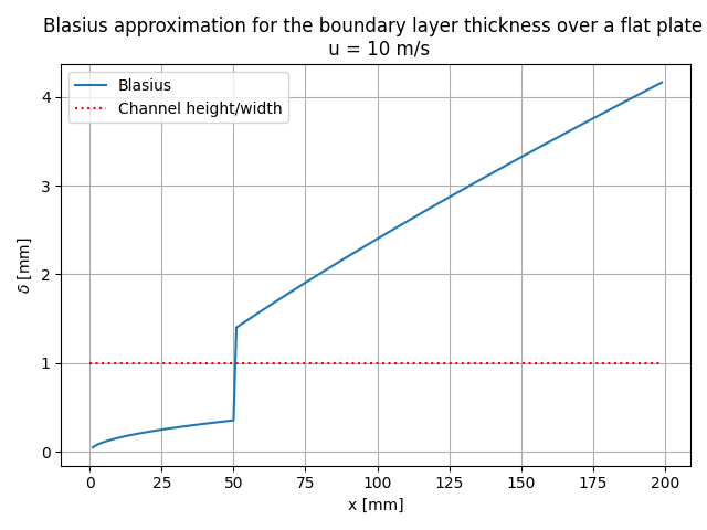

I think I understand your point about the square cross-section resembling flat plates. My interpretation is that the tube consists of 4 flat plates as long as the viscous boundary layers do not interfere with each other / do not overlap. To this end I have used Blasius' approximation to determine at what position x along the length of the tube the viscous boundary layer becomes larger than the distance between opposing plates, which in this case is the channel height/width (actually half of that, but this does not change the argument). In the top figure below, we can see that a transition from laminar to turbulent (Re ~ 5e5) around 50 mm, which is the length of the tube, hence the setup of the current simulation is indeed about flat plates.

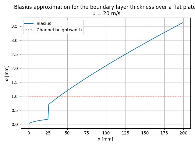

The second picture shows Blasius' approximation for twice the inlet velocity, namely u = 20 m/s. Here we can observe that the transition from laminar to turbulent occurs within the domain of my current setup, which is at x = 25 mm. This means that the flat plate approximation should not be visible throughout the whole domain, but some sort of pipe flow should be present as well.
The simulations for u = 20 m/s are being run while this is being posted, so the above is still hypothetical.

Ansys EmployeeSST does predict the natural velocity overshoot on the centerline which is what I expect.
Continue running and doing assessments on iteration error, discretization errors. Do not rely much on all of these correlations: estimate the entrance length from them only and multiply by a factor and run the cases.

Ansys EmployeeFor the u=20 m/s case, from the beginning of the tube to ~ x=25 mm, the flow is laminar (i.e. Re < Re_transition of flat plate). In such a case, it doesn't make sense to use a fully turbulent model to simulate this problem. You should instead use one of the transition models. As for the grid requirement, the general rules of thumb are
First cell centroid aty+~ 1
Expansion ratio of grid in wall normal direction not to exceed~ 1.1
Grid clustering should be dense and expansion ratio should be small even in the streamwise direction in order to properly capture the transition location.
Hope this helps.
