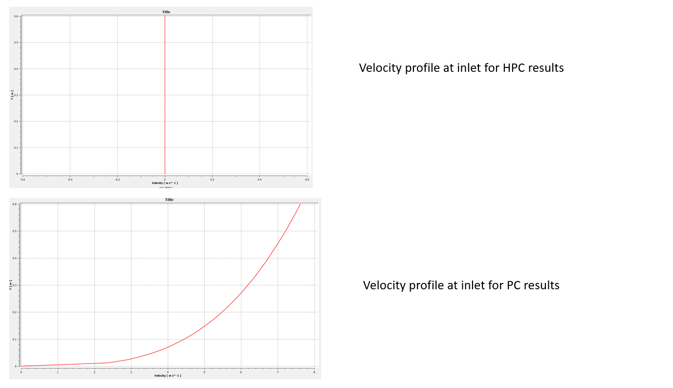

      I am trying to run a simulation both on my PC and HPC but velocity profile at the inlet is comletely different in both the results. My simulation involves a UDF. Can someone point out how this can be fixed?

      Case for the files is same. I have  checked for velocity profile at the inlet and its showing absolutely 0 for the inlet for HPC results whereas when run on PC , its showing the correct profile. I am attaching some pictures
      So, the UDF profile didn't load on the HPC. Did you recompile the .c file on the cluster?

      Yes I did and it did compile because I can see velocity at other portions of my domain but just at the inlet its zero.
    • Ramesh Chandra Mishra
      I think I am writing boundary conditions wrong in the jornal file. Can you somehow confirm whether the command in journal file is correct for booundary conditions.
      If the inlet is zero how is flow happening elsewhere?

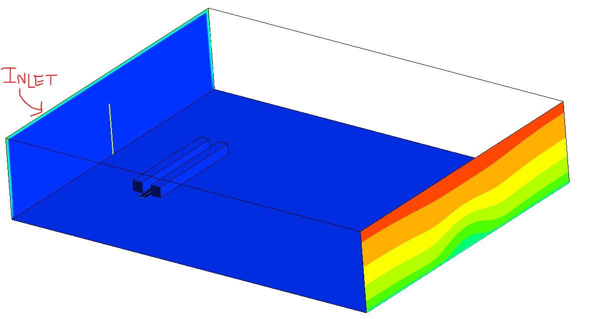

      I am attaching my contours for reference.

      As a guess you've got a pressure boundary and buoyancy?
      You need to check the command. The exact form of the TUI commands (the yes/no bits) is very dependent on what other models are active. So, the turbulence model may add an extra yes/no and some number inputs.
      In the TUI the command /define/something can be run from any level of the TUI menu.  define/something will only work if run from root (top level).
      No buoyancy. I have got velocity inlet and pressure outlet. In velocity inlet, I have specified UDF.
      Looking at the image it's not hooked up correctly, so you need to check the command. I'd also be looking at the HPC result to understand how you got the flow pattern you're seeing.

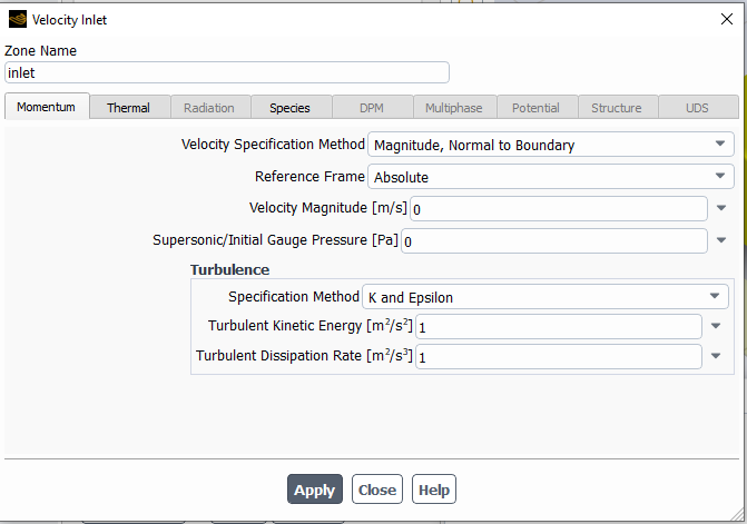

      In order to run the simulations on HPC, I do not load UDF in my case file. So in boundary conditions, velocity magnitude remains zero. I am attaching a screenshot for the same. Could that be a reason?
      Yes, if the inlet is set as zero that's the velocity that Fluent will use.

      Okay. But I cannot run my simulations with UDF loaded in case file. It gives errors. I have tried that.
      Can you tell me the correct way?
      PS: My velocity profile is specified in the UDF.
      If you don't load the UDF then you won't get the same velocity profile and so aren't modelling the same conditions.

      Hi Rob.
      I got the correct results. The problem was with the inlet boundary conditions . Like you said, velocity magnitude zero will give the zero results. I corrected it.
