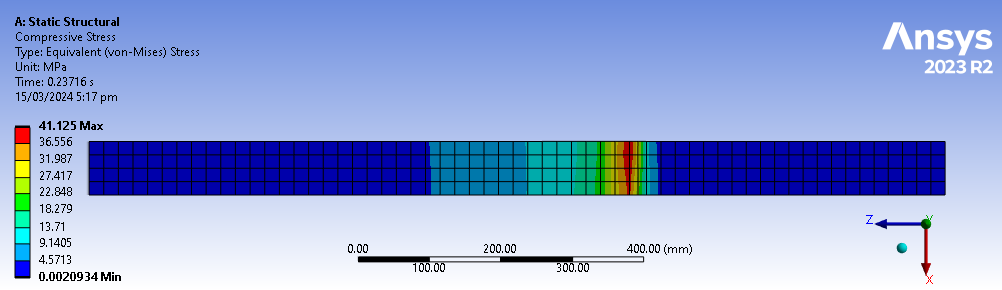

      I'm trying to model an RC beam subjected to 4 point bending test. I am doing a displacement-controlled model using remote displacements directly on the face of the beam but I noticed that the stresses and strains are concentrated on that face itself. In reality, the middle portion of the beam (to the right of the face) should be experiencing higher stresses and strains, which is not the case in my model as shown.

      1. What can I do with my first model so that the stresses and strains are not concentrated at the loading face itself?
      2. What can I do with this current model so that the values are not underestimated?

      Hi
      See if this tutorial (link below) helps. So just use a displacement with y non zero and x and z free on an edge – so do not use a remote displacement with all zero except of y of course. The tutorial also shows how to extract the failure load (force reaction of imposed displacement).
      As for why you get different values, could be many things (material properties etc.) . In theory it could be able to capture the failure of a RC beam.
