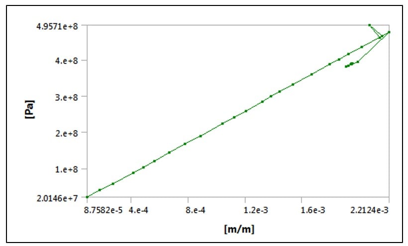

      Hello, I have Question about Stress-Strain Diagram with Max Principal Stress and von Mises Stress, could you please tell me why the curve at the Plastic part is not the same? Obviously the curve is at first diagram correct but at second Diagram not correct. You can see the Diagram below.
      Stress-Strain Diagram with Von Mises Stress:
      Stress-Strain Diagram with Max Principal Stress:
      Thanks for your helping.
    • Sandeep Medikonda
      Because, von-mises and principal stress definitions are quite different?
      See this.
    • Hoosein86
       Thanks for your answer, I read the Article but unfortunately I didn't completely understand, could you please explain base on the Grafiks that I show?
      Thank you.
      Create a Single Element model using a displacement on one face to create stress and strain in the element, then plot the different types of stress and see what the graphs look like then.
