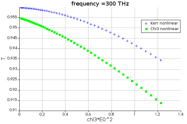

SubscriberI need to check response of a dielectric film considering only third order nonlinearity. It seems there is two way to define it.
1)chi3/chi2 material --> only chi3 has nonzero value (e.g. 1e-19) and base material is defined seperately with a (n,k) material with n=4,k=0 (no loss);2)kerr nonlinear --> permittivity =16, chi3= 1e-19.
As I ran the 2D sim with a plane wave source and sweeped the amplitude (E0), the T response was different. Here is a plot for a film thickness of 125nm.
Can anyone help me understand the difference in dynamics of these two material types? Thanks. -

Ansys EmployeeThose two models do not apply for the same material, as chi2/chi3 model needs non-zero chi2. If it is pure chi3, please use the chi3 material-Kerr model only. Example can be found here  https://optics.ansys.com/hc/en-us/articles/360041718634-Kerr-effect-on-Gaussian-beam-propagation
