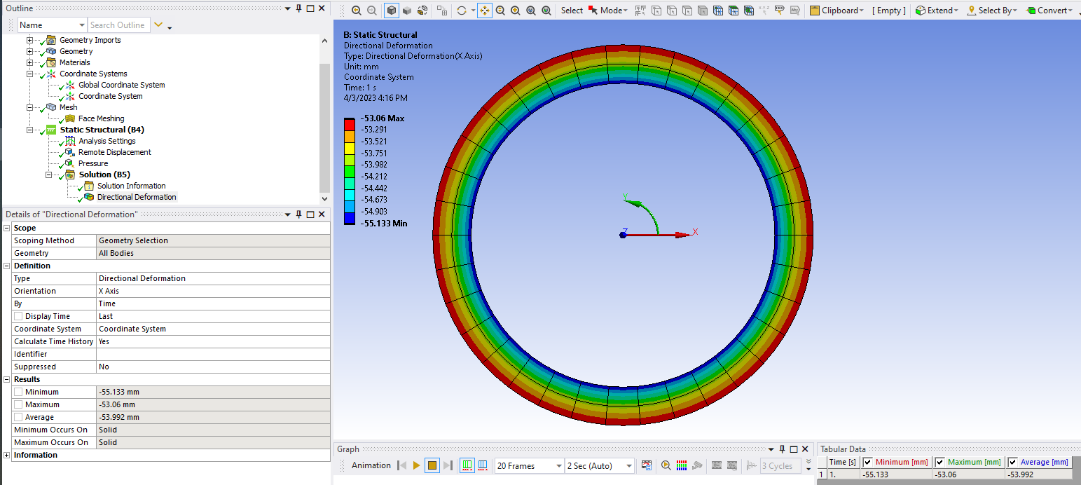

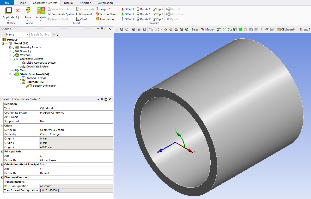

SubscriberPlace a Cylindrical Coordinate System on the cylinder axis, with the Z axis pointing along the cylinder axis. The X coordinate measures Radial deformation.
Add a Directional Deformation, set it to use the Cylindrical Coordinate System and to plot the X coordinate. The contours will be radial deformations.
Since you know the initial radius of the cylinder, subtract the radial deformation and double that to get the compressed diameters.

SubscriberThank you for the ideal! But i have the problem that i dont know how to set up for the cylinder axis. If it's not too bother you, can you make an exemple for me how to set it up to calculate the radial deformation?
Thank you so much! Have a great day
