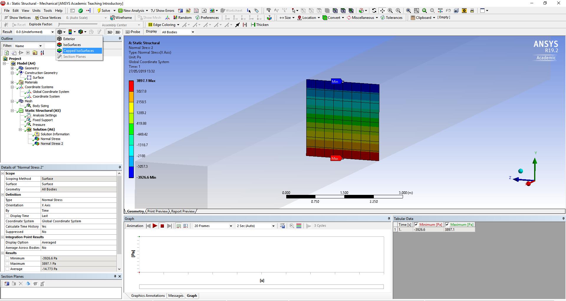

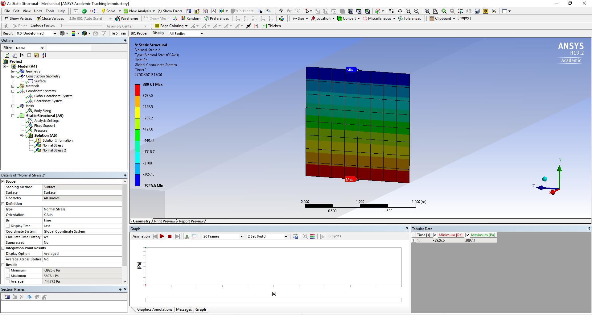

After completing the solution, I can exploit the results on the body.
But how can I determine the area of a region with stress (or any result) greater than the predetermined value?
For example, the figure below is the stress result of one face, I want to calculate the area of the region with stress greater than 80MPa.
Is this possible?
Thank you.

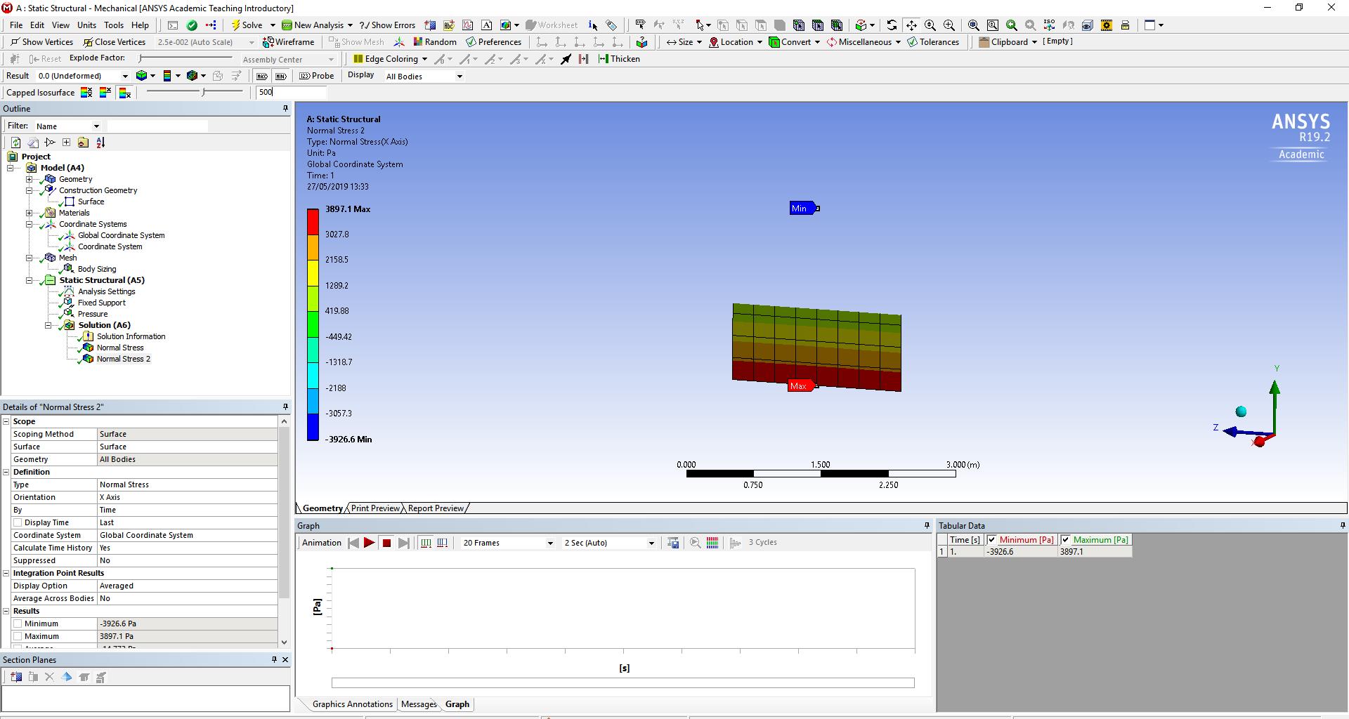

SubscriberHi,
Thank you for your help.
But that way only visualize the region greater or less than a result, can not get area value of it. I want to get area value.
Ex, original surface have area = 100m2. On it, 1/4 region have stress greater than 100 --> the value I get = 100/4=25m2
May 27, 2019 at 3:44 pm
jj77
SubscriberSee engtips fea AnPham - this is the best I can come up with and absolutely valid from an FEA point of view (so edit:thin membrane shells are often used to get better surface stresses on 3D parts, made of bricks)
