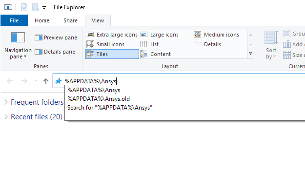

    • Dreko
      'Can you try exiting all ANSYS applications and then try renaming your %APPDATA%Ansysv181 directory to v181.old?'
      Hello I am having same issue, but using a remote desktop to access ANSYS, where can I rename the above
      Thanks?
    • Matt Madore
      Dreko open a file explorer and type %APPDATA%Ansys into the address bar. You can then rename the directory for the version you're running.

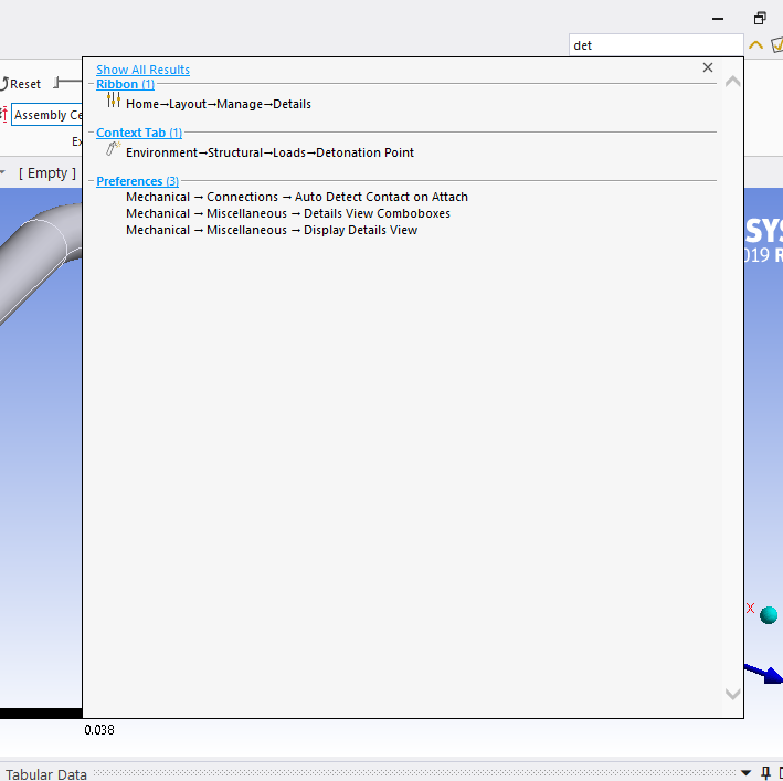

    • Subroto
      IN quick launch section in the upper right , type details , and you will get a list in which go to first opotion and your details menu will resume

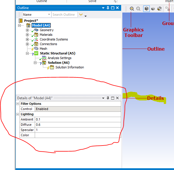

    • Ortega
      How could I please bring back the interface Details panel in Mechanical Workbench as I show in the first screenshot?
      I tried following all the indications from Ansys help and the one posted above, but it was unsuccessful.
      I attached a screenshot of what I am looking for
    • Ortega
    • Sefa guluzadeh
