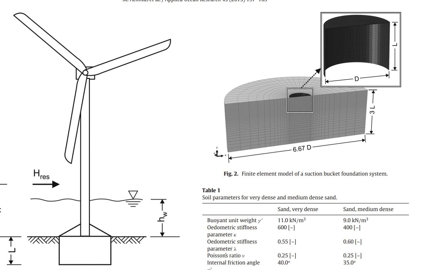

      For this model, you are interested in the sand and its ability to withstand the loads from above, so the structure above can be simply a way to transfer load to the buckets.
      I assume you don't care about the stress in the bucket material and how the top of the bucket connects to the tower.  You need to draw three buckets in SpaceClaim or your own CAD system. The buckets are just simple cylindrical surfaces with a flat top, and construct solid bodies that represent the soil that is in each bucket and outside all the buckets out to a radius of 3*(S+D) and below the buckets to a depth of 3L.

      yes actually  i  don't care about the stress in the bucket material and top of bucket i assume is integrated with the tower, however, in reality, they are welded together
      i want to see and get the  Deformation and rotation of structure when the sea wave load is applied to the structure
      The bucket diameter is varied as 6, 9, 12, and 15 m
      skirt thickness was fixed at t=25 mm
      skirt length is varied as 3,4.5,6
      (S/D)critical=1.5, 2
      i also attached those pictures in order to be cleared

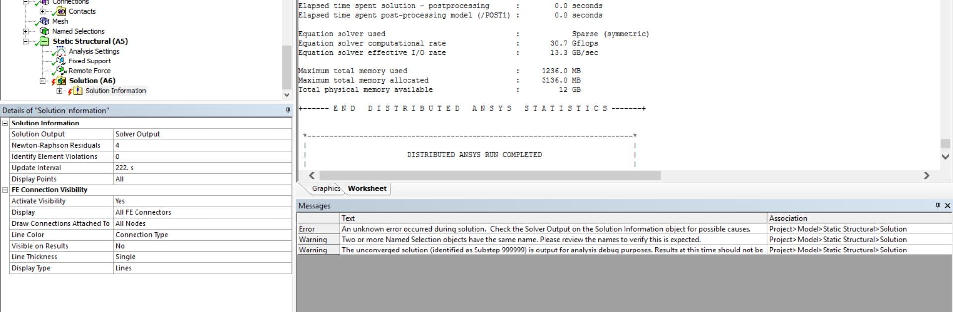

      i have problems
      first of all , when i defined the material properties in the engineering data then  i go for refreshing the project, in the model option the question mark appears  not the mark shows it's ready for solving
      but after that when i go into project i can assign the materials that i  have already defined to the buckets and the soils and then i followed your setting for the mesh and solving then click on the solve tab but i have faced with this error
      please guide me
      Please follow the directions for creating a Workbench Project Archive .wbpz file. Then attach that file to your reply. I can look in that file to see what is wrong. Note that the file must be less than 120 MB to attach. You might need to RMB on Model and Clear Generate Data to reduce file size.

      I downloaded the archive you saved in the previous post. You seem to have overcome the problem in the post that had the ? in the Model item. This model actually started solving.
      If you click on Solution Information, you will see a long text file of the solver output.  One of the messages is this:
       *** WARNING ***                         CP =      14.125   TIME= 8:28
       The material solution failed for element 6063 with material 11.
       The material solution failed for element 6069 with material 11.
      This means that the displacements that went into the mohr-coulomb material model did not compute a valid output. This often happens with Geomechanical materials like mohr-coulomb. All my examples in the model building videos used simple linear elastic materials.
      Here is an illuminating discussion where a member was trying to compute stresses in a mine shaft. As soon as the mohr-coulomb material model was added, an error occurred. It was because the model boundary conditions (Fixed Supports) generated tensile stresses that the mohr-coulomb material model couldn't handle. As soon as better boundary conditions were applied, the model solved because there were no longer spurious tensile stresses.
      A second discussion on mohr-coulomb.
      A third discussion on mohr-coulomb.
      I recommend you make a very simple model of some soil and a wall, as simple as you can think of, and use that model to see how to get the mohr-coulomb material model to solve. Maybe a rectangular block of soil in a rectangular bucket. Move one wall of the bucket in or out and see what happens.
      Let's close this discussion, as it was a good example of how to do everything except the soil. Please create a New Discussion to ask questions about this new simple model that uses mohr-coulomb, because this discussion is already marked as solved.

      i want to ask you if you run it without any problem ???
      because when i start to run( exactly the file I upload for you), i am facing with this error and stops, i do not what to do i checked again all parameters but did not work

      Dear Yasser,
      If you take the model you attached above, and scroll up in the Solution Output, you will see the warning messages I showed you about the material.
      If you open that model and in Engineering Data, delete the Mohr-Coulomb model from the soil, Refresh the Project and Solve the model, it will solve without error. That archive is attached.
      That is why you need to take some time to understand the Mohr-Coulomb material model and ask questions in a New Discussion.
