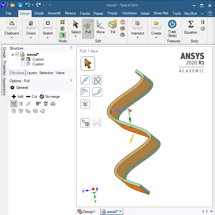

SubscriberHi,
I wish to create a surface with a certain thickness by extruding a a sinusoidal profile (like the image below).
August 28, 2020 at 9:52 pmAugust 31, 2020 at 12:43 pmrouzbeh
Subscriberthank you very much Peter.nI did not use SpaiceClaim bevor. I am trying now to make my Geometry using SpaceClaim. In my Geometry this sinusoidal spring is inside a container. I didn't find out how to make a tengent constraint between the lines of container in the sketch and the sinusoidal curve. if there are gaps between container and spring, then I will get the problem in contact of Static structural.n
thank you in advancen n
August 31, 2020 at 4:54 pmpeteroznewman
SubscriberYou know what the amplitude of the sinusiod is and its axis, so just use dimensions to put the lines in the right place relative to that axis.nAfter you mesh, there may be a tiny gap between the nodes and elements at the tangent point. Use the Adjust to Touch setting in the Frictional Contact Details to close that tiny gap.nSeptember 1, 2020 at 1:55 pmrouzbeh
SubscriberI have 32 cases to study, I wanted to set a tangent constraint and for each case just modify the amplitude, in order to save the time. so do you mean the only way is using dimensions to put the line in the place?nSeptember 1, 2020 at 4:24 pmSeptember 1, 2020 at 8:26 pmpeteroznewman
SubscriberSweep is not necessary on a rectangular surface with Face Meshing. You should get Quad elements without a Sweep. Delete the Sweep Method.nSeptember 2, 2020 at 7:09 amrouzbeh
Subscriberthank you peter,naccording to my slender geometry I need SOLSH190 elment, if I use just Face Meshing to get Quad elements, the elements are not Solid shell anymore, are they? nRegardsnSeptember 2, 2020 at 8:44 pmpeteroznewman
SubscriberYou have very thin walled parts. Do not use solid geometry and do not mesh with solid elements is my recommendation. If you must use solids for some reason, such as a non-uniform wall thickness, then SOLSH190 is the best choice.nUse surface models. You can extract a midsurface from a uniform wall thickness solid, or just start with surfaces and don't use solid geometry at all. When you bring surface geometry into Mechanical, you mesh it with quad shell elements like SHELL281 quadratic elements. The surfaces are assigned the thickness as a property, along with a material.nAugust 10, 2023 at 3:39 amKawshik
