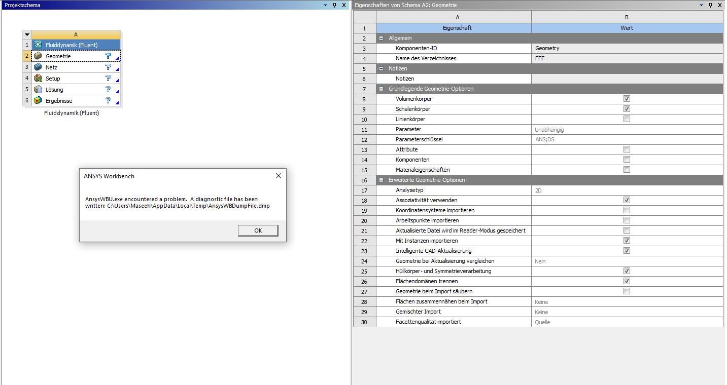

November 1, 2018 at 1:11 am
nikunj patel
SubscriberHello
Thanks for the replyÂ
My computer has only Intel HD graphics(intel xenon processor). I do not have any extra graphics card such as Nvidia and Radeon. So is this enough to run Ansys student?
ThanksÂ
Nikunj
November 1, 2018 at 3:54 pm
tsiriaks
Ansys EmployeeHi Nikunj,
If the graphics card is not in the tested/supported list, we cannot guarantee the outcome, it could go either way.
I would recommend to try some other resolutions first if they don't help, then it's the issue with your graphics card. You could also try just updating the graphics driver of your integrated Intel graphics and see if that helps. Also, see if you have the option to set the power plans for your Intel graphics to be maximum performance like what is described here
https://support.serato.com/hc/en-us/articles/202305784-Changing-graphics-card-settings-to-use-your-dedicated-GPU-on-a-Windows-computer-
Thank you,
Win
