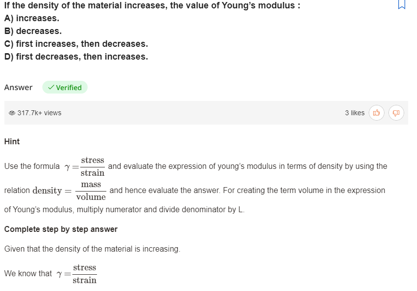

      can you have a look at the below link ? It shows relation between Density and Young's Modulus.
      https://www.vedantu.com/question-answer/if-the-density-of-the-material-increases-the-class-11-physics-cbse-5fb7bff76ad6283e70aead0b

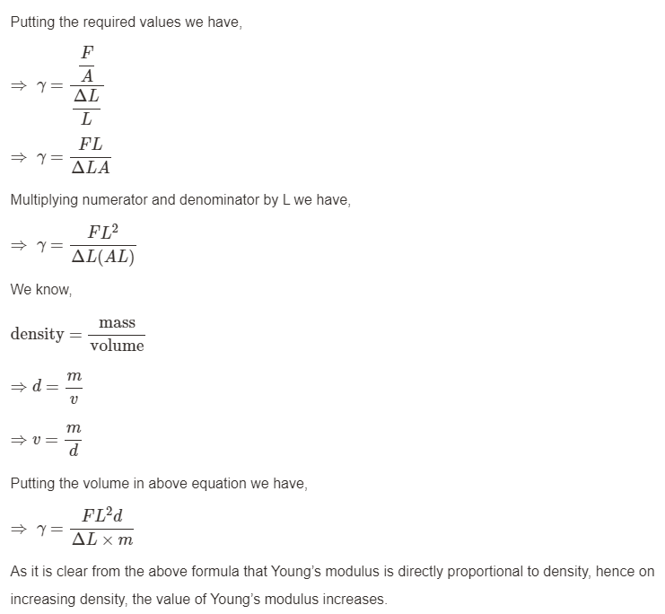

      The link that I shared shows the proof of relation between Density and Young's Modulus. So, I just wanted to understand why in ANSYS, it is not taken as a co-relation. Or if may be I am going wrong somewhere. That's why I created this discussion. May be someone else can help me out on this forum.
      Anyway, thanks Erik.
      I would wait for some more replies to this discussion.
      Below is a copy of the question and answer.
      This example fails to explain Young's modulus or elasticity and draws incorrect conclusions.
      This example does not introduce the concept of Poisson's Ratio, where the cross-sectional area increases as the length decreases due to compression.  Poisson's ratio must be used in the calculation of the volume with the compression becuase if the Poisson's Ratio is 0.5, then there is no volume change. Only when Poisson's ratio is 0 will the volume change in the equations used in this example be correct. There are very few materials that have a Poisson's Ratio near zero.

      Even if we introduce Poisson's ratio formula here, still the formula would contain Density in proportion to Young's Modulus and isn't poisson's ratio also directly proportional to Young's Modulus [Y=2G(1+μ)] ?
      I find the whole exercise is misleading and not worth discussing further. I suggest you watch the free course available on this site if you want to learn about elasticity.
