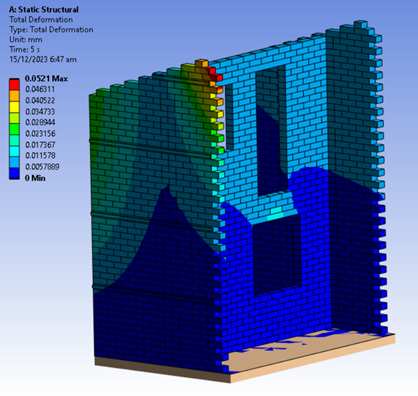

      Hello, I did a pushover analysis of a portion of a brick structure with frictional contacts. My problem is that the deformed model is not showing, only the contours of Total Deformation. I have tried downloading the animation but it doesn't show the deformed model. If it helps, the maximum deformation I have is 0.052 mm.or

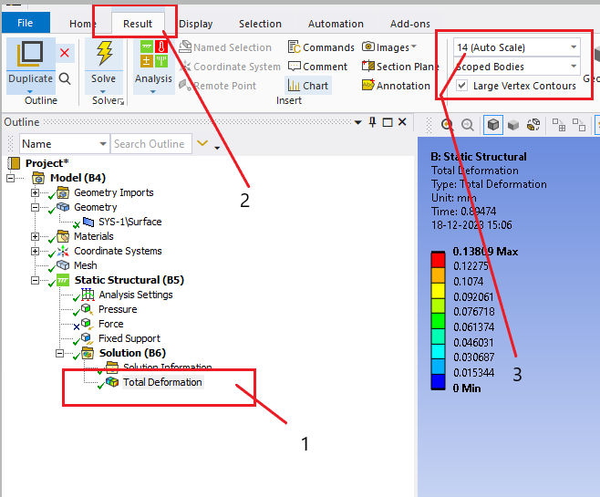

      Hi Winsam,
      I think the deformation is small, so you cannot see the significant movement of the model.
      select the deformation under the solution --> Select the result tab--> Change the scale value to see the deformation. There's a possibility that the simulation would have chosen the "true scale".
      If the method mentioned above doesn't help then please let me know.
