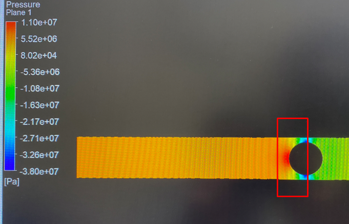

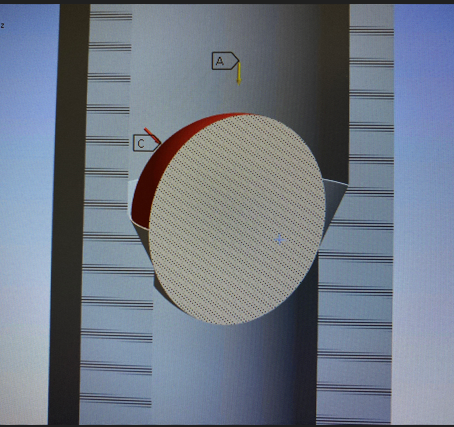

The task is to determine water hammer. With what force will the water hit the ball on the seat.Water is supplied to the well (pipe), in front of the water there is a steel ball, the water will move the ball strongly until it hits its seat. It is necessary to understand with what force the impact will be, whether it will deform the seat:
In which module is it easiest to do this? It is necessary to take into account the density of the liquid. Is it possible to do this in static or transient analysis? Or only fluent? Tell me a brief sequence of actions and then I will figure it out. Thank you.

SubscriberSir I need to understand with what force the ball will hit the saddle
October 10, 2024 at 10:51 am
Rob
Forum ModeratorYes, and the pressure will determine the ball speed (and if there's any fluid cushion) as it hits.Â

Forum ModeratorI'd look at Fluent 6DOF if fluid was important and then pass the speed/force over to Mechanical (or rather I'd get one of our Mech staff to do that bit).Â

javat33489
Subscriberno sir, because the ball moves with the flow.
Sir, I understood that I need to bring the ball with the help of 6DOF. I will do it.
But how to measure the voltage on the ball and the saddle when the ball rests on the saddle?

Forum ModeratorIf the ball rests on the saddle it's not moving, and it's in contact: neither are going to need CFD, and one is not permitted by the 6DOF model.Â
May 20, 2025 at 7:14 pm
javat33489
SubscriberMy task is a ball that moves towards a saddle and then hits it.
May 21, 2025 at 9:05 am
Rob
Forum ModeratorWhich comes back to the original points: you need to understand what Fluent can offer in this regard with the 6DOF solver and what the limitations are.Â
May 21, 2025 at 5:23 pm
javat33489
SubscriberSir I know that maybe DOF will do its job and bring the ball to the seat. But I need to understand how the seat and the ball will be damaged by the impact.
May 29, 2025 at 9:12 am
Rob
Forum ModeratorWhich again brings us back to understanding the limitations of moving mesh in Fluent. And then working out what data to transfer to Mechanical or Dyna to solve the contact problem.Â
