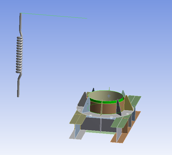

      I am new in the use of ansys and I have this problem: I would like to create a point mass link to the surface and the end vertex of the line body highlighted in green. I tried to do creating a point mass but I can’t select faces and vertex at the same time. I would like to know if there is a way to do so.

      What if you try to create a remote point where it is scoped to surface and vertiex and use then this remote point to create a mass over there?
