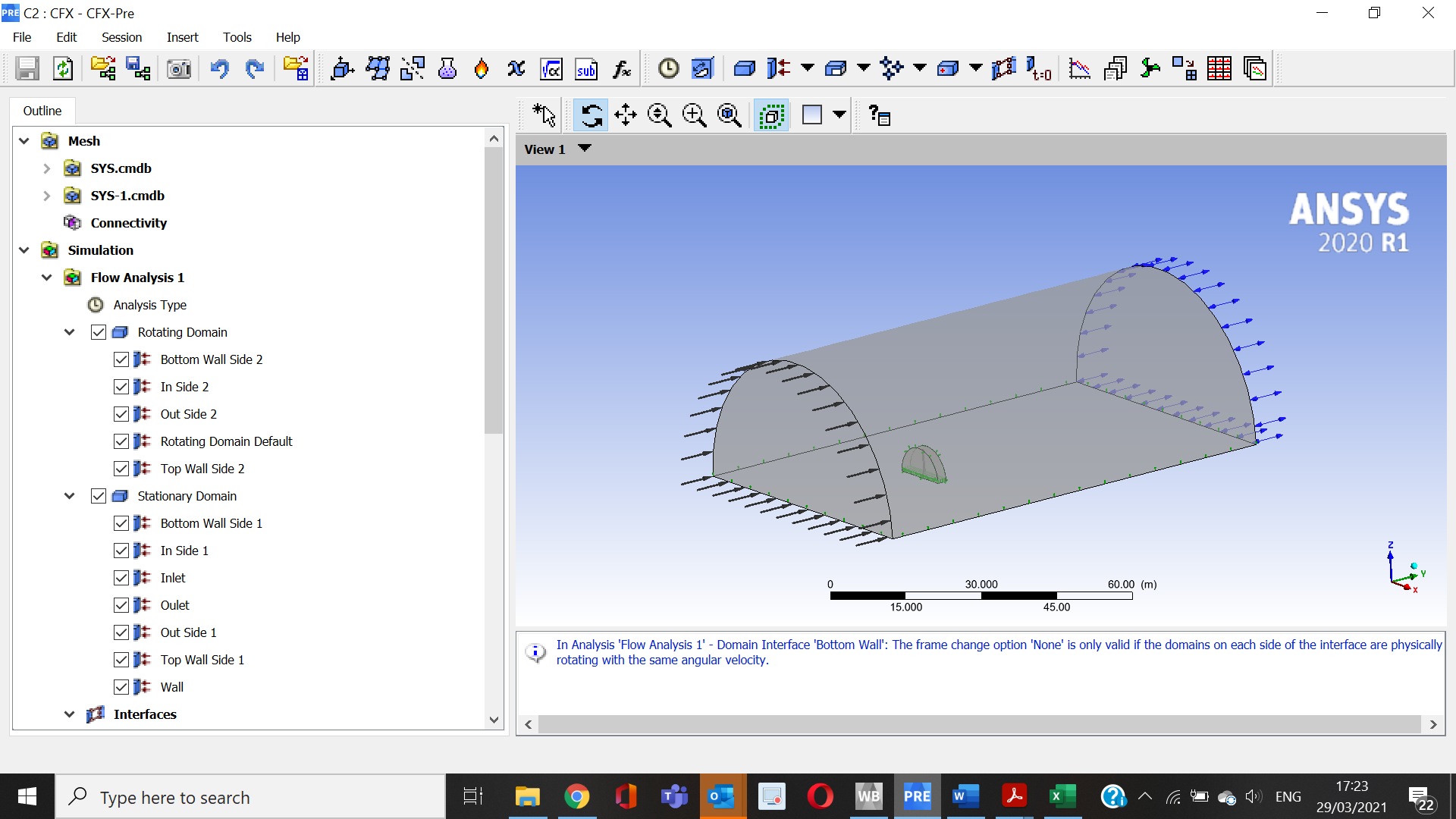

Kindly assist how i can define rotational periodicity of a half cylinder domain?. I want to simulate fluid flow for a two blade rotor wind turbine. To cut of computational time, I have only modelled half the rotor and one blade and i need to map the simulation results to the other half.

Ansys EmployeeHello, nIf I understand correctly, then you could actually use 1/4th of a sector and then make the 2 side faces rotational periodic to each other.nPlease check this link : https://ansyshelp.ansys.com/account/secured?returnurl=/Views/Secured/corp/v211/en/cfx_mod/CACCCIFH.htmlnRegards,nSDnnViewing 1 reply thread- The topic ‘Defining periodicity of a half cylinder domain’ is closed to new replies.
