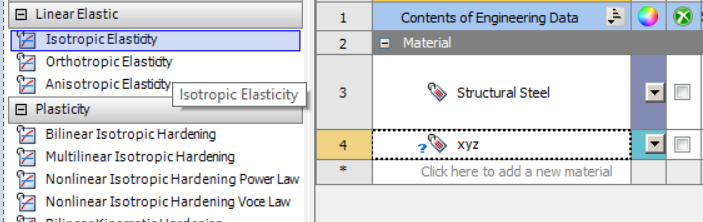

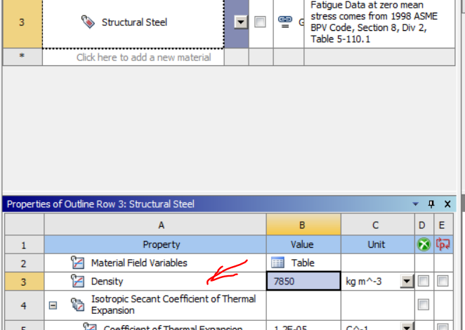

    • Ashish Khemka
      Please see if the following snapshots help you:
      Regards Ashish Khemka
