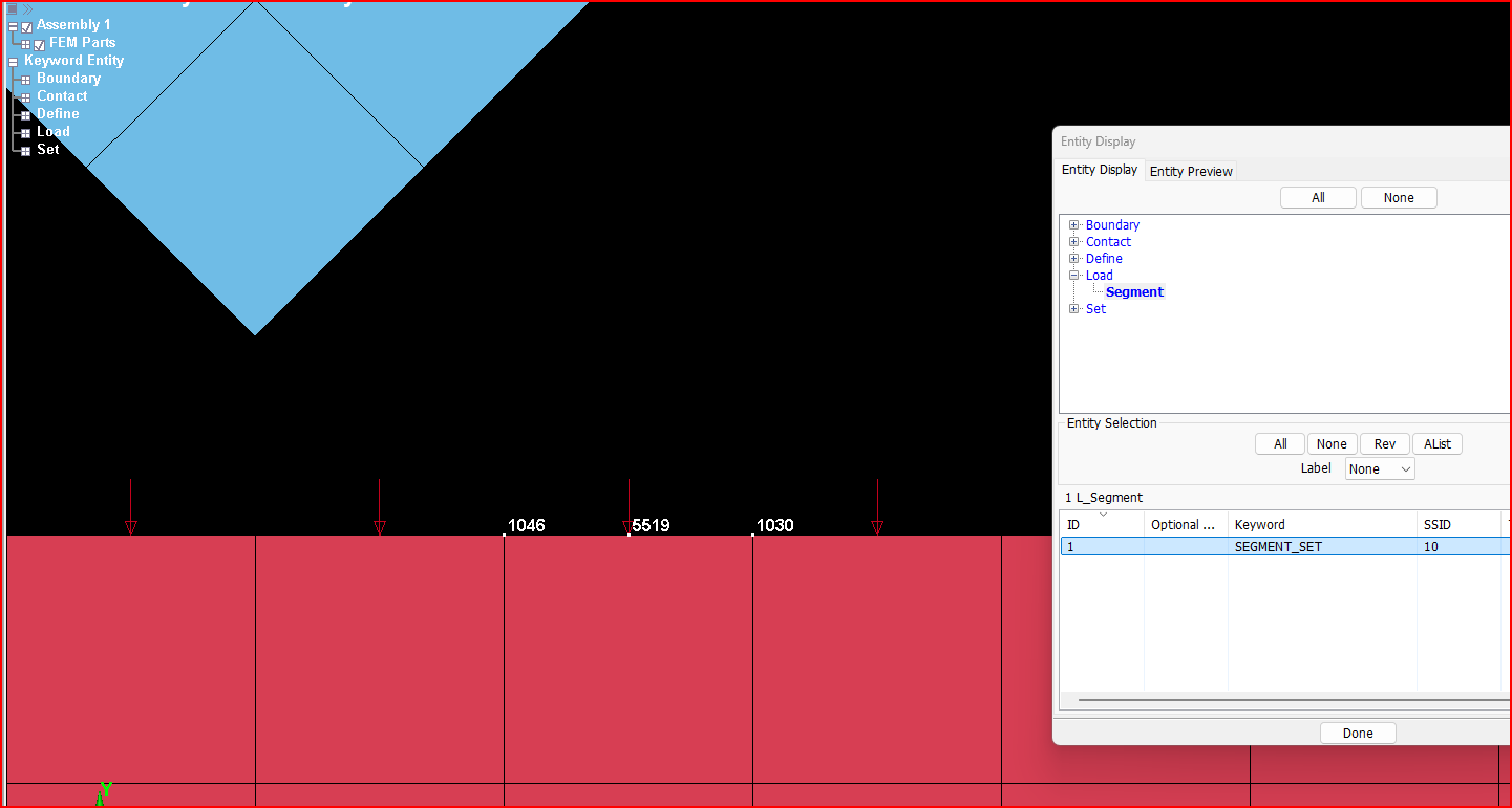

      How should the load segment and segment set be defined for 2D plane stress geometry modeled using Q8 elements elform = 23? Each edge has 3 nodes.

      Thanks. Tried using LSPP to create a segment on the edge. It does not appear to detect the mid side node. It defines the segment as shown below. This definition does not seem to apply the loads during the simulation.
      *SET_SEGMENT_TITLE
      left edge
      $#     sid       da1       da2       da3       da4    solver       its         -
               1       0.0       0.0       0.0       0.0MECH               0
      $#      n1        n2        n3        n4        a1        a2        a3        a4
               2         1         1         1       0.0       0.0       0.0       0.0
               3         2         2         2       0.0       0.0       0.0       0.0
               4         3         3         3       0.0       0.0       0.0       0.0
               5         4         4         4       0.0       0.0       0.0       0.0
               6         5         5         5       0.0       0.0       0.0       0.0

    • Dennis Chen
      I adjusted a previous model I made to try this and is below what you are hoping to see?  if so, you can do this using the mesher inside workbench ls-dyna.   Using a 2D analysis, change element order to quadratic and plane-strain so elform 13 is written out into the input file.
      Hope this helps.   I also made a video last week on this topic but it's not related to mid-side node, I adjusted it just now to try out the idea.
