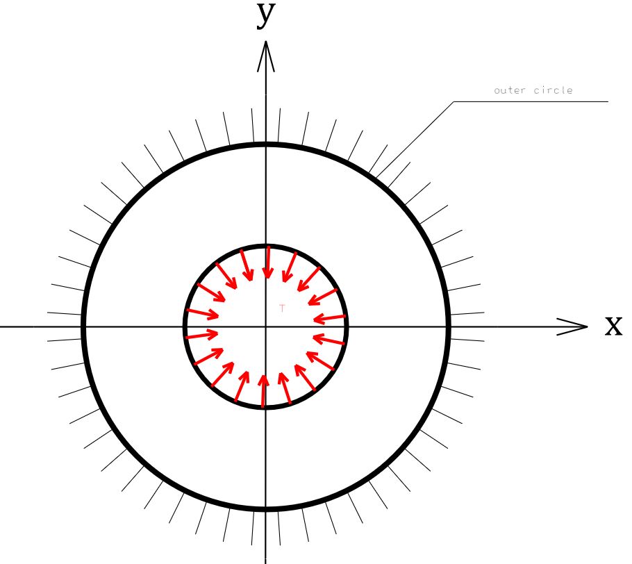

I am trying to define boundary conditions on midsurface according to following picture
radius of inner circle is 0,2127m, outer circle: 0,8508m and the thickness of membrane (modelled as a midsurface) is 0,001metres.
Youngs modulus of material is E=11,9*10^10 Pa, density is 790kg/m^3.
The goal is to create uniform normal tension 11,9N/mm in whole membrane (create pretension for further modal analysis).
Red arrows in the picture represents uniformly distrubuted tension (11,9N/mm), normal to inner circle. Outer circle is clamped.
It is not difficult to define clamped (outer) edge, however i dont know how to define this tension, which is normal to inner edge.

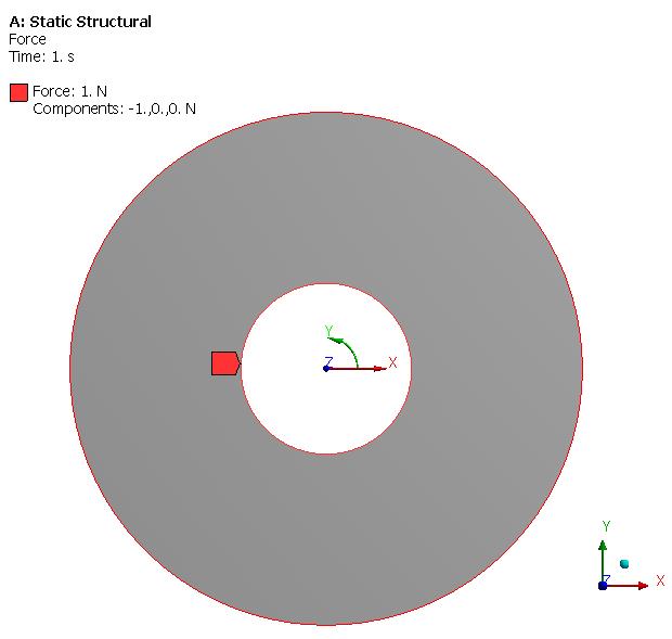

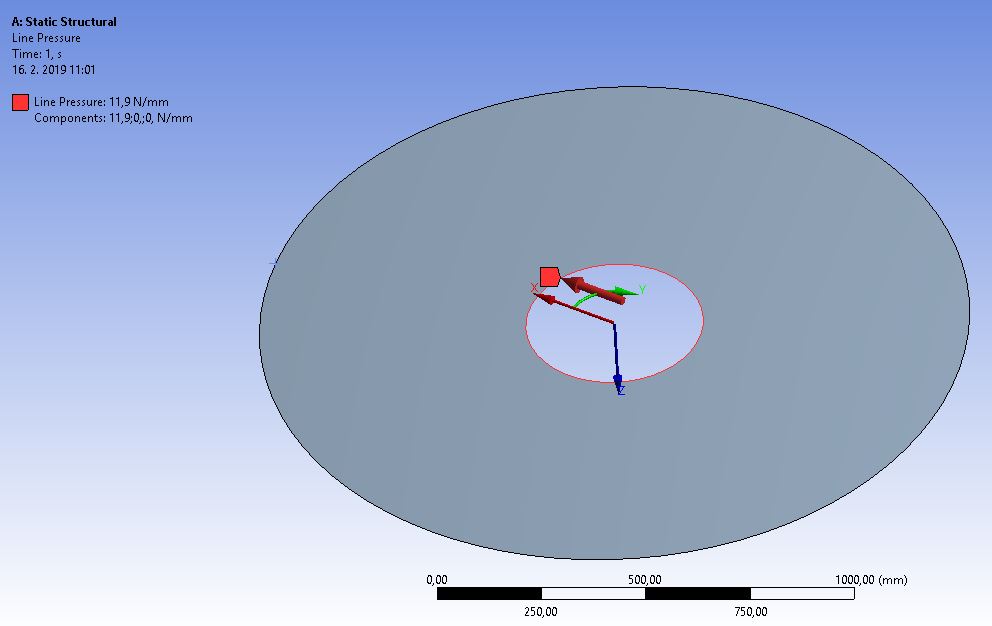

I created cylindrical coordinate system, however i have problem to define direction of tension (radial direction).
In this picture You can see what i got:
The problem is, tension is applied in x-axis. Not in radial direction. There has to be an easy way how to define radial direction. -

SubscriberIn a Cylindrical coordinate system, the X axis is the Radial Direction.
February 16, 2019 at 1:56 pm
kravky
Well, it can not be in my case, since the results of tension i got were not riadially symmetric. Actually, the reslutant tension corresponded to the fixed X axis, not radial axis.

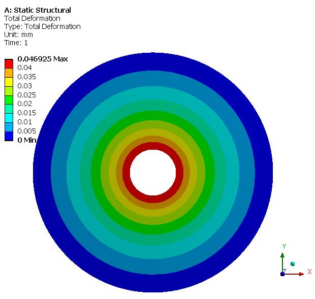

SubscriberOh, acttually i got the same result now. It is correct. However is it possible to create somehow UNIFORM tension? in whole structure?
i searched for INISTATE in help, but it did not help me
inner edge is free and outer edge is clamped, therefore we cant use thermal load. -
February 17, 2019 at 3:20 am
peteroznewman
SubscriberA uniform membrane tension is possible with fixed edges as I demonstrated in another discussion. It is physically impossible with a free edge because equilibrium requirements forbids that from happening at a free edge.
