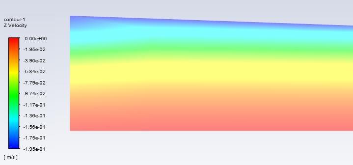

      I have this fluent simulation of a lubricated gap, one of the walls is moving. The simulation is running fine and now i am stuck at evaluating the results.
      One of the results i need to verify is the velocity distribution on the outflow. I do get this nice rainbow surface, which is what i expected, but i am very bad at determining colors, so i want to extract some values along a line so i can determine whether or not the velocity distribution is correct.

      Have a look in Create > Surface > Line in Fluent (Results section of the ribbon). Experiment with line & rake to see what's best for your needs.

      But is there a way to use premade named selections/components? Doing this using coordinates feels unnecessary tedious...
      The line/rake is the one i should use to get a set of results along a line? So i am at least on the right track!

      Yes, but you need to define & label geometry and then mesh blocks. Ie you label the boundary between two shapes in the geometry and plot on that: you'll get a line in 2d & a face in 3d.
