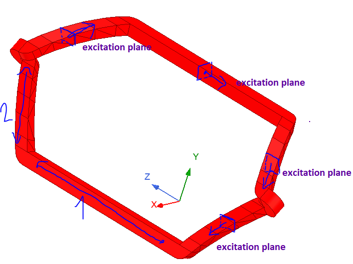

SubscriberHi,
I have the following 3D solid block coil geometry in Fluent 2021 R2. It has a higher thermal conductivity in the direction normal to the excitation plane compared to in-plane thermal conductivities. For example, for portion 1, the thermal conductivity is higher in the z-direction. For portion 2, thermal conductivity is higher in the z-y direction. Since the excitation plane changes direction at different parts of the coil, the coil has a varying thermal conductivity in XYZ directions along its path.
Can you help me to define this anisotropic changing thermal conductivity for this geometry in ANSYS Fluent?
Thanks!Â

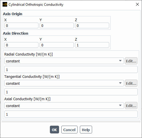

To define anisotropic thermal conductivity for a solid material, select anisotropic for Thermal Conductivity in the Create/Edit material dialog box.

Forum ModeratorIn the above you can use UDFs but the easier approach will be to create a few different materials, and split the solid into separate volumes based on the direction.Â
It's a problem I've seen a few times, and one I can't easily answer here. However, it's also a nicely drawn up specification to pass onto the Product team.Â

SubscriberHi Rob,
Thank you for your answer. Creating different materials based on the direction would solve the problem.Â
You suggested turning on the material orientation in the solid cell zone. How do I do that?

Forum ModeratorUse the cyclic option in the material and then there's an option in the solid cell zone panel for orientation. If it's not there have a look in 2023R1
