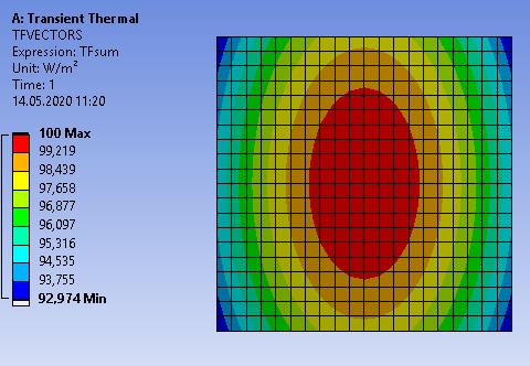

May 14, 2020 at 9:22 am
Rohith Patchigolla
Ansys EmployeeHi Varun,

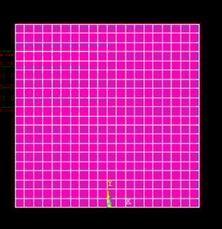

I tested your script on a 1x1 m^2 square plate in XY plane with centroid located at origin, in ANSYS Mechanical in v2019R2.
The Heat flux applied looks like this picture below.
So, it looks to be working (i.e. as a point source, with peak of 100 at center, i.e. X=0, Y=0).
Please let me know your comments on why you think it is not working at your end? Please check if you are using the correct units in Mechanical while solving, while the numbers in the command object will be interpreted in the solver unit system.

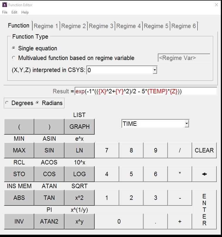

May 27, 2020 at 7:43 am
Rohith Patchigolla
Sorry for the delay.
You mentioned earlier that the absorption coefficient, alpha is a linear function of temperature. You can incorporate this very easily while defining the function in the Function Editor in Mechanical APDL GUI.
I tested a small example (i.e. using the below function in Mechanical via Command object) and it seems to work as expected (i.e. varies as a function of X, Y, Temp and Z). In the below example, I used alpha = 5*Temp (i.e. a linear function).

Please try this at your end and let me know if you have any questions.

May 27, 2020 at 12:58 pm
varunkash
SubscriberHi Rohith,
Thanks for your response. I tried this. Although the code works in giving a Gaussian profile like before, the variation with respect to temperature doesnt seem to be reflected. I tried to vary the linear equation with different coefficients. All of them give the same profiles. Also, the profile remains the same with or without the incorporation of TEMP in the equation.
Also, can you let me know if this TEMP function takes in feedback from surface temperature?
Thanks.
Varun
May 27, 2020 at 1:05 pm
Rohith Patchigolla
Please note that the temperature effect is reflected only once a load step is completed.
For example, in LS 1, Temp value is taken as "Initial Temperature" --> by default 22C. Then once the LS1 is solved and we move on to LS2, the Temp value is now taken as Temperature calculated at the end of LS1. As mentioned earlier, I have verified this on a simple model with two loadsteps.
If you have only 1 load step, you cannot see the temperature effect we don't have access (by default) for temperature results at each substep. You can look into using USRCAL command to access these Temperatures at each substep, to get this effect. If not, to see the temperature effect, I would suggest to use multiple loadsteps, applying the heatflux using this function via Command object at each loadstep.
Hope this clarifies.
Best regards,
Rohith

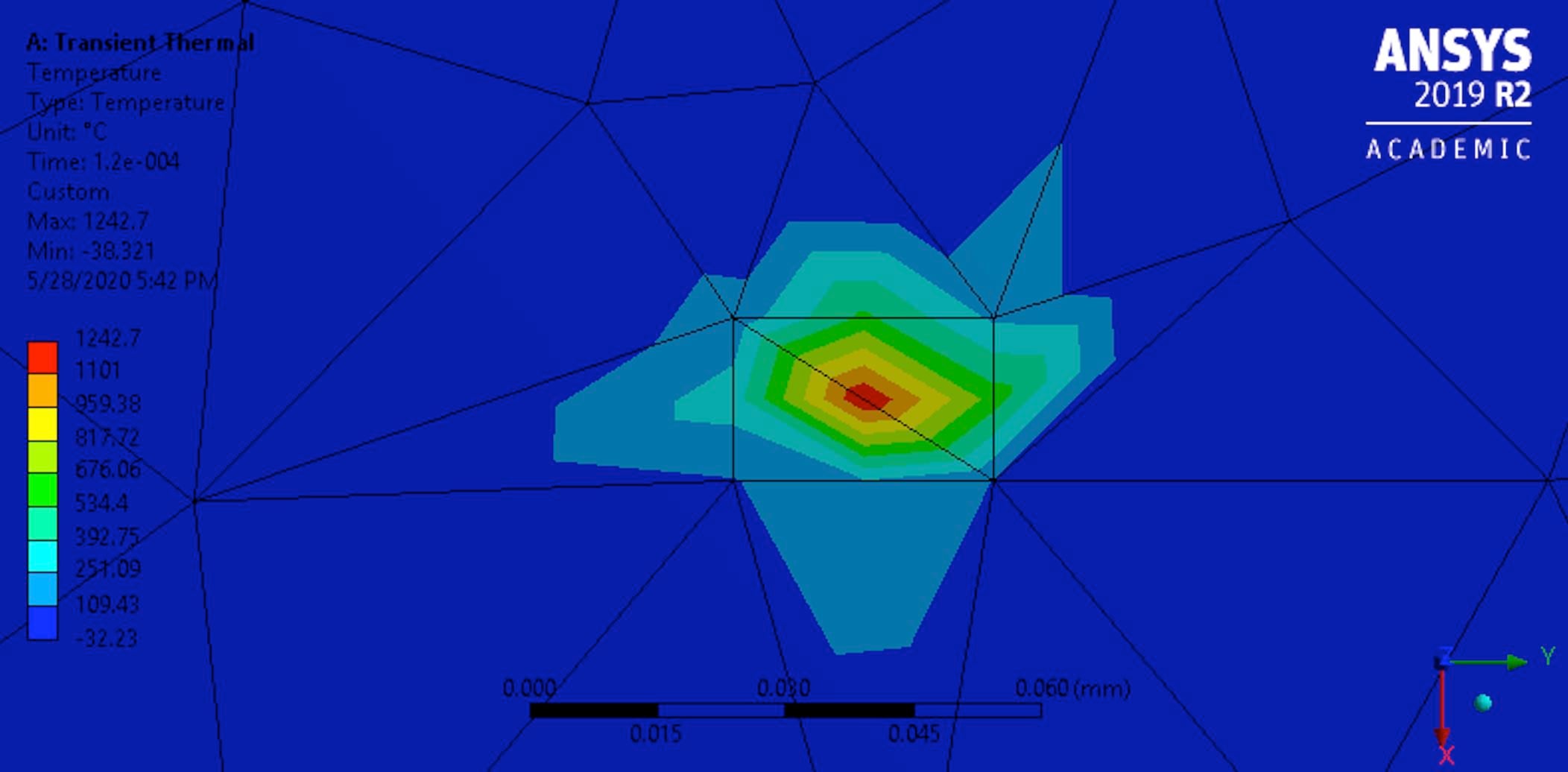

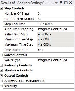

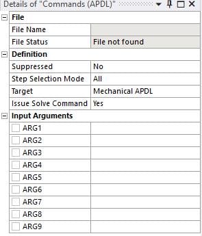

May 29, 2020 at 1:29 pm
varunkash7
SubscriberHi Rohith. Thanks for your response. So, I simplified my model to check this. RIght now, it is just a 20 micron sheet of polyimide (kapton) on which I apply a point Gaussian heat source. The final script I am using is below.
The snapshot of details box of command object can be seen below
On the analysis settings, the number of steps is 3, Each time step is 40 microseconds, total of 120 microseconds as seen below. Initial temperature is 22 deg Celsius.
There are no other loads currently. Just convective boundary conditions on all walls. The model view in the XY plane is shown below.
Thanks for your help Rohith.
Best,
Varun

Rohith Patchigolla
Thank you for providing me the details. Please paste the text of your script (instead of an image), so that I can test the same at my end on a simple case.
Also, from your results, I see you are experiencing thermal undershoot i.e Initial temperature = 22 C, Min Temperauture at 120 microseconds = -32.23 C, which should not happen.
Please have a look at Thermal analysis guide --> Specifiying load step options in ansys help
Number of substeps per load step, or the time step size
A nonlinear analysis requires multiple substeps within each load step. By default, the program uses one substep per load step.
In regions of severe thermal gradients during a transient (e.g., surfaces of quenched bodies), there is a relationship between the largest element size in the direction of the heat flow and the smallest time step size that will yield good results. Using more elements for the same time step size will normally give better results, but using more substeps for the same mesh will often give worse results. When using automatic time stepping and elements with midside nodes (quadratic elements), ANSYS, Inc. recommends that you control the maximum time step size by the description of the loading input and define the minimum time step size (or maximum element size) based on the following relationship:
ITS = Δ2 / 4 α
The Δ value is the conducting length of an element (along the direction of heat flow) in the expected highest temperature gradient. The α value is the thermal diffusivity, given by k/ρC. The k value is the thermal conductivity, ρ is the mass density, and C is the specific heat.
If the above relationship ITS = Δ^2/(4*alpha) is violated when using elements with midside nodes, the program typically calculates unwanted oscillations and temperatures outside of the physically possible range. When using elements without midside nodes, the unwanted oscillations are unlikely to occur, and the above recommendation for the minimum time step can be considered somewhat conservative.
Hope this helps.
Best regards,
Rohith

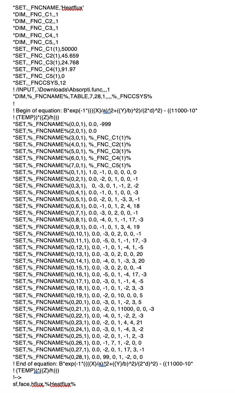

May 29, 2020 at 1:51 pm
varunkash
SubscriberThanks Rohith. Here is the text of the script.
*SET,_FNCNAME,'Heatflux'
*DIM,_FNC_C1,,1
*DIM,_FNC_C2,,1
*DIM,_FNC_C3,,1
*DIM,_FNC_C4,,1
*DIM,_FNC_C5,,1
*SET,_FNC_C1(1),50000
*SET,_FNC_C2(1),45.659
*SET,_FNC_C3(1),24.768
*SET,_FNC_C4(1),91.97
*SET,_FNC_C5(1),0
*SET,_FNCCSYS,12
! /INPUT,.DownloadsAbsorpti.func,,,1
*DIM,%_FNCNAME%,TABLE,7,28,1,,,,%_FNCCSYS%
! Begin of equation: B*exp(-1*((({X}/a)^2+({Y}/b)^2)/(2*d)^2) - ((11000-10*
! {TEMP})*({Z}/h)))

*SET,%_FNCNAME%(0,25,1), 0.0, -2, 0, 1, -1, 2, -3
*SET,%_FNCNAME%(0,26,1), 0.0, -1, 7, 1, -2, 0, 0
*SET,%_FNCNAME%(0,27,1), 0.0, -2, 0, 1, 17, 3, -1
*SET,%_FNCNAME%(0,28,1), 0.0, 99, 0, 1, -2, 0, 0
! End of equation: B*exp(-1*((({X}/a)^2+({Y}/b)^2)/(2*d)^2) - ((11000-10*
! {TEMP})*({Z}/h)))
sf,face,hflux,%Heatflux%
May 29, 2020 at 6:24 pm
varunkash
SubscriberHi Rohith, I tried calculating and defining minimum time step size using this equation. However, I still see a similar trend. Is there something else I can try to rectify this?
Best,
Varun
June 2, 2020 at 8:44 am
Rohith Patchigolla
Could you try re-running your model with linear elements instead of default (quadratic) and let me know the results?
Best regards,
Rohith -

Subscribercan anyone explain what the numbers in the row and columns of the heat flux table mean?
*DIM,_FNC_C1,,1
*DIM,_FNC_C2,,1
*DIM,_FNC_C3,,1
*DIM,_FNC_C4,,1
*DIM,_FNC_C5,,1
*SET,_FNC_C5(1),0
*SET,_FNCCSYS,12
! {TEMP})*({Z}/h)))
*SET,%_FNCNAME%(0,0,1), 0.0, -999
*SET,%_FNCNAME%(2,0,1), 0.0
*SET,%_FNCNAME%(3,0,1), %_FNC_C1(1)%
*SET,%_FNCNAME%(4,0,1), %_FNC_C2(1)%
*SET,%_FNCNAME%(5,0,1), %_FNC_C3(1)%
*SET,%_FNCNAME%(6,0,1), %_FNC_C4(1)%
*SET,%_FNCNAME%(7,0,1), %_FNC_C5(1)%
*SET,%_FNCNAME%(0,1,1), 1.0, -1, 0, 0, 0, 0, 0
*SET,%_FNCNAME%(0,2,1), 0.0, -2, 0, 1, 0, 0, -1
*SET,%_FNCNAME%(0,3,1), 0, -3, 0, 1, -1, 2, -2
*SET,%_FNCNAME%(0,4,1), 0.0, -1, 0, 1, 0, 0, -3
*SET,%_FNCNAME%(0,5,1), 0.0, -2, 0, 1, -3, 3, -1
*SET,%_FNCNAME%(0,6,1), 0.0, -1, 0, 1, 2, 4, 18
*SET,%_FNCNAME%(0,7,1), 0.0, -3, 0, 2, 0, 0, -1
*SET,%_FNCNAME%(0,8,1), 0.0, -4, 0, 1, -1, 17, -3
*SET,%_FNCNAME%(0,9,1), 0.0, -1, 0, 1, 3, 4, 19
*SET,%_FNCNAME%(0,10,1), 0.0, -3, 0, 2, 0, 0, -1
*SET,%_FNCNAME%(0,11,1), 0.0, -5, 0, 1, -1, 17, -3
*SET,%_FNCNAME%(0,12,1), 0.0, -1, 0, 1, -4, 1, -5
*SET,%_FNCNAME%(0,13,1), 0.0, -3, 0, 2, 0, 0, 20
*SET,%_FNCNAME%(0,14,1), 0.0, -4, 0, 1, -3, 3, 20
*SET,%_FNCNAME%(0,15,1), 0.0, -3, 0, 2, 0, 0, -4
*SET,%_FNCNAME%(0,16,1), 0.0, -5, 0, 1, -4, 17, -3
*SET,%_FNCNAME%(0,17,1), 0.0, -3, 0, 1, -1, 4, -5
*SET,%_FNCNAME%(0,18,1), 0.0, -1, 0, 1, -2, 3, -3
*SET,%_FNCNAME%(0,19,1), 0.0, -2, 0, 10, 0, 0, 5
*SET,%_FNCNAME%(0,20,1), 0.0, -3, 0, 1, -2, 3, 5
*SET,%_FNCNAME%(0,21,1), 0.0, -2, 0, 11000, 0, 0, -3
*SET,%_FNCNAME%(0,22,1), 0.0, -4, 0, 1, -2, 2, -3
*SET,%_FNCNAME%(0,23,1), 0.0, -2, 0, 1, 4, 4, 21
*SET,%_FNCNAME%(0,24,1), 0.0, -3, 0, 1, -4, 3, -2
! {TEMP})*({Z}/h)))
