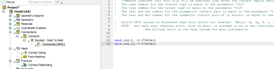

      Please use the commands below.
      RMODIF, CID,3 & RMODIF, CID,11 are used to modify the normal and tangential stiffness through commands of your contact region for debonding.
      you can start with the following command under the contact and change the normal/tangential stiffness. (Mode II debonding is mainly governed by the tangential stiffness. hence, you can start by reducing the tangential stiffness and run the simulation.
