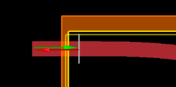

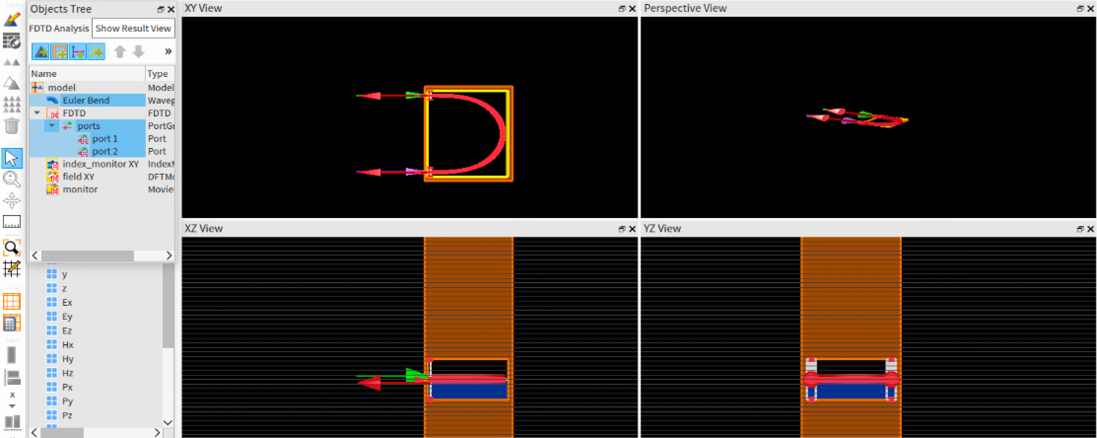

SubscriberI am simulating an 180 degree bent waveguide with 3D FDTD, the version is 2025 R1 on GPU. Mesh is 3, only using Si and SiO2 in the material library. PML on all direction except z max is symmetric. The setup is shown in the following pic:

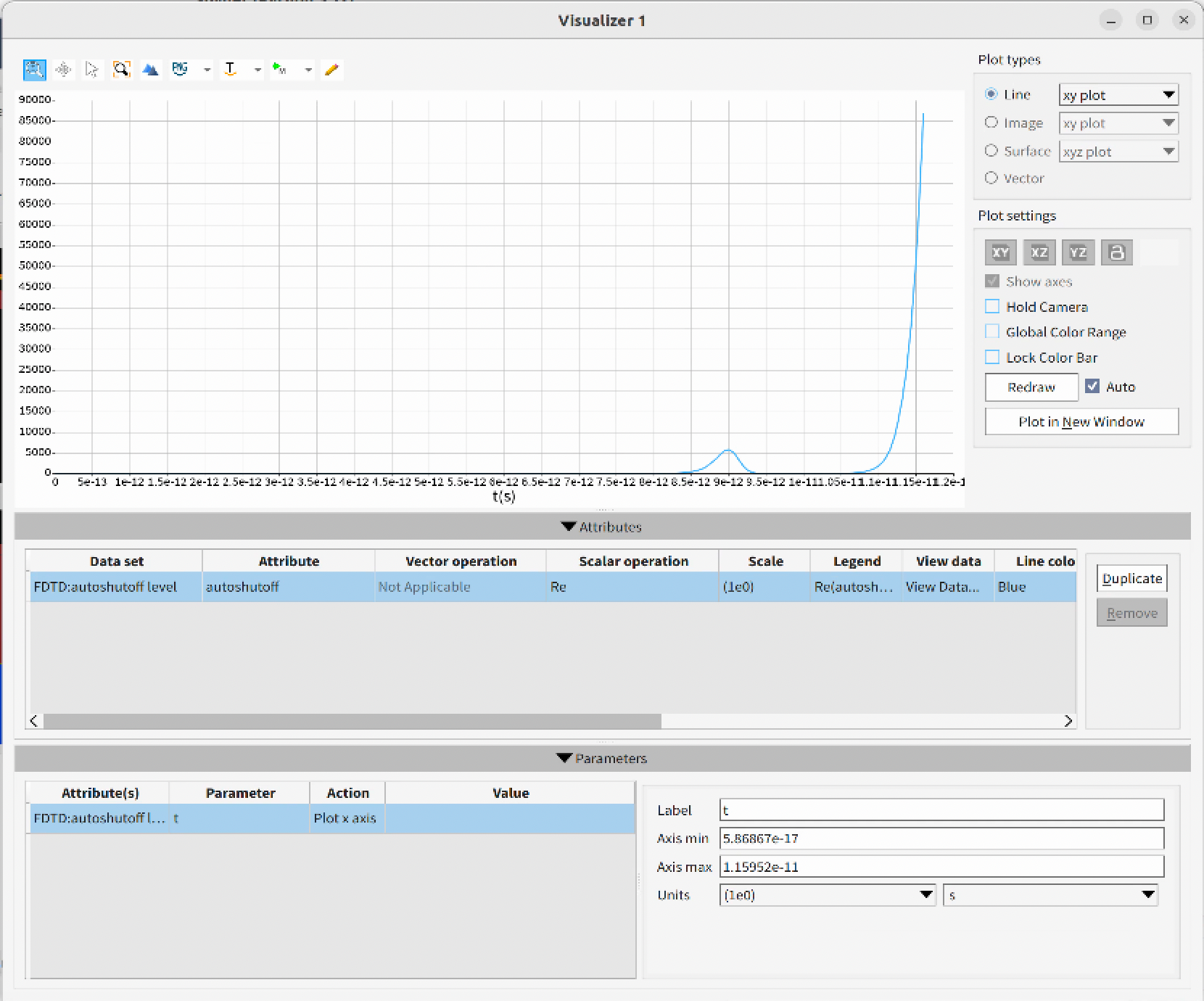

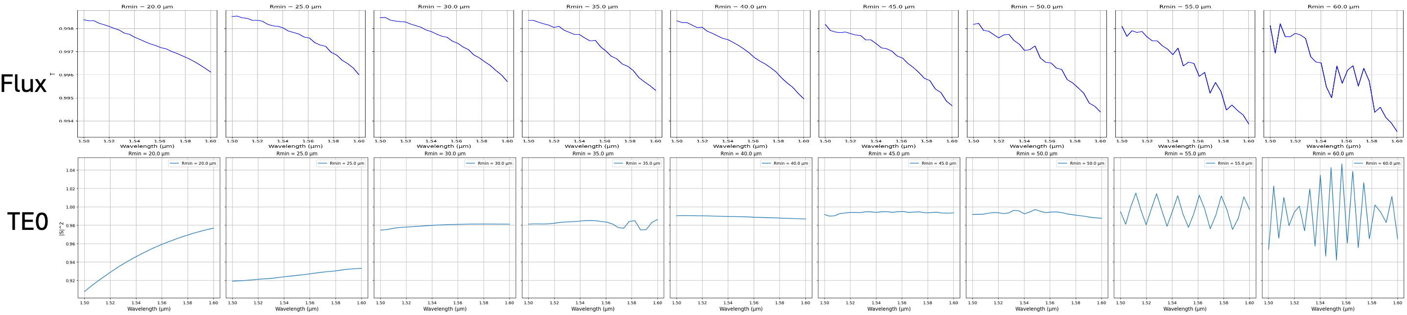

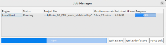

I am running a sweep from small to big bend, the size is from around 50x50x1 um to 170x170x1 um. I noticed the simulation is stable for smaller bends, and get unstable for larger bends and significantly diverged for biggest bends (I see the autoshutoff value rise much more than 1 after runing a few hours with the biggest rings), see the following summery.

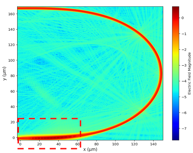

Also I noticed, for all those diverged bend simulation, there seem to be a "hot spot" on the E field plot at some part of the waveguide

On a 50x50um bend (small one, cuz the big ones takes too long), First I tried changing all boundaries to Metal, and there seems no divergence (the autoshufoff value is always very close to 1 even after a long simution time), thus I concluded that mine is PML type of divergence.
I first tried to change the PML profile to "stable", but interestingly, this seems lead to 0.03 percent of reflection after each time the pulse hit the PML boundary. I see the autoshutoff value go from almost 1 to ~0.03 then to ~0.0009 in a long time simulation. And the autoshufoff value is constant when the simulation was running between these three points. This is strange, cuz if I change the profile back to "standard", the there seems to be minimal reflection. the autoshutoff min reached and it triggered the early shutoff while running. I assume "stable" in theory should have much more complete absorption...
I also tried "stable" PML profile on big simulations, autoshutoff level still runs high

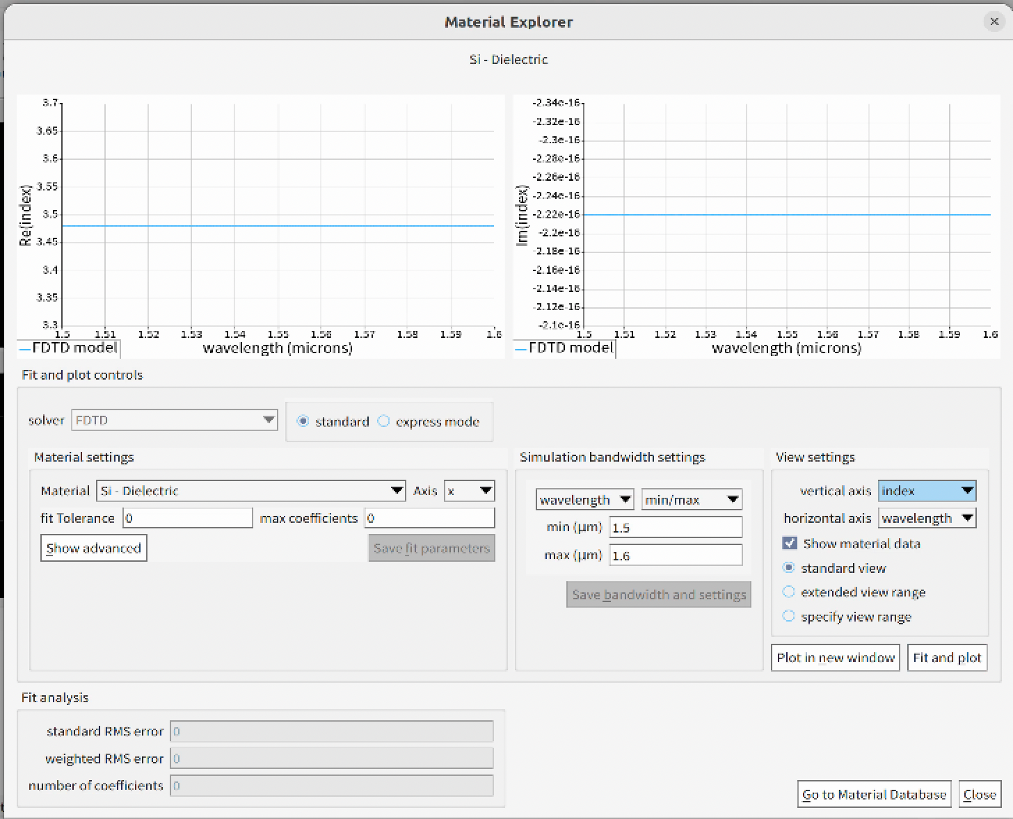

I also thought about the possibility of dispersion material, but it seems 25R1 on my computer gas issue with Visulizer. But I checked the system check, the material "Error RMS" is ~0.02 and I am just using silicon and silicon dioxide.

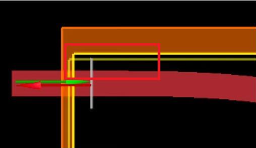

This sounds like a tricky simulation to debug, and glad you are following all the right steps. Thanks for the very detailed explanation of what you've tried so far. I am wondering if there might be an issue with the entering and exiting waveguides having a slightly non-normal incidence with the PML boundary (judging by your screenshots). Have you tried moving the PML boundary further back along -X such that you intersect where the waveguide is perfectly normal to the boundary? The reason that I ask, is that guided radiation at oblique incidence is a known issue with PML.
You could also try changing the materials to non-dispersive, where you just use "object defined dielectric" with matching index values for the primary wavelength of interest. This would make sure it isn't a dispersion or material fit issue as well.Ethan

I also tried using all simple dielectric material with a single value index, I still see divergence happening:

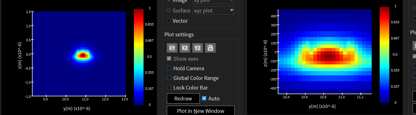

Okay, there are a few more suggestions I have. The first has to do with your source. You will want to make sure that the source is wide enough that the fields have sufficiently decayed near the edges (~1e-05) to avoid diffraction effects:
For instance, you want your injected fields to look like that shown on the left not the right.
Second, you will want to make sure that these fields are sufficiently decayed near the PML boundary.

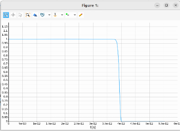

Thanks for the advice! I double checked the span of ports, it does seem like the fields are not fully decayed at the boundaries in z direction! After fixing this, I did eliminate the divergence issue! Thanks!
T/S^2 vs wavelength:
autoshutoff value:Â

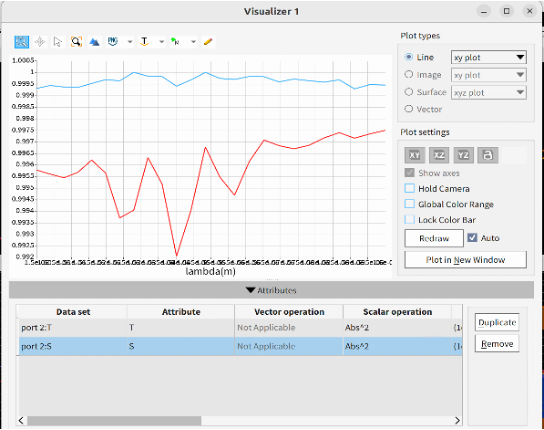

One further question I have is that it seems the results (T/S^2 vs wavelength) is a not quite smooth, which I assume it is becasue of the relatively low mesh accuracy (mesh accuracy = 3), but my simulation is too big, increasing the accuracy to 4 might not be pratical. I wonder if there is any advice on improving the results further?
