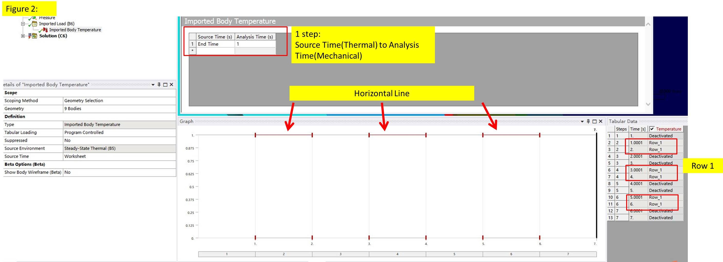

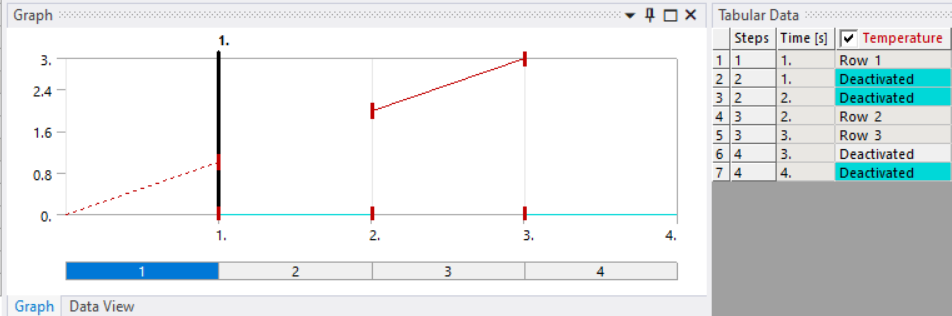

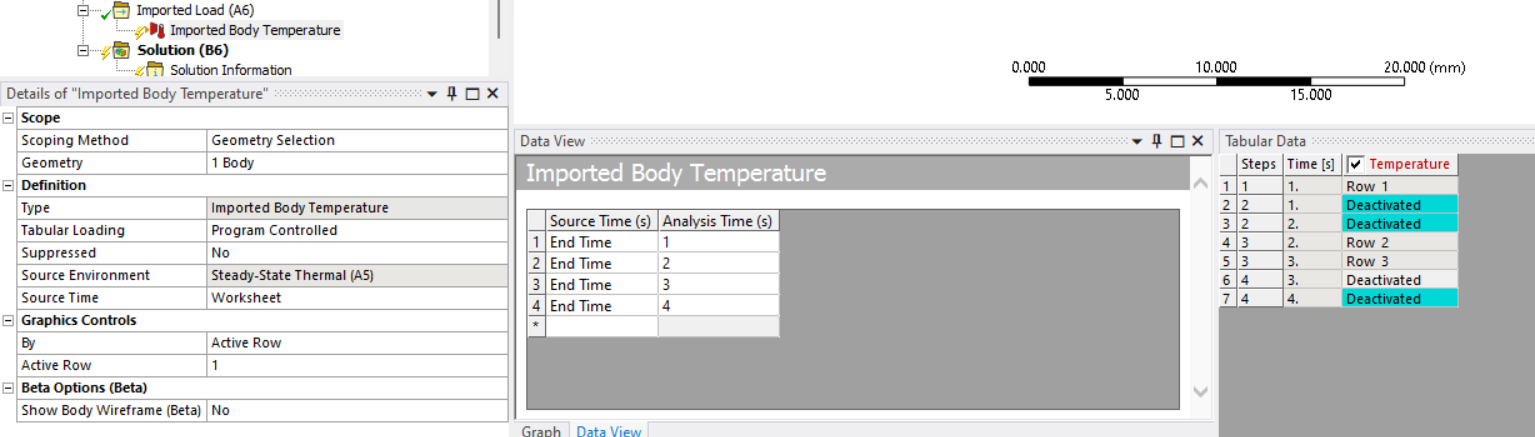

SubscriberI have one bar with two ends. A one-step steady-thermal analysis was performed first to get the temperature field of the bar in which the temperature changes from one end of the bar to another end of the bar. Next the temperature field was imported into the static structural analysis which has multiple steps of loading and unloading. For example, it has 4 steps. The first step is to apply the transverse pressure and temperature field obtained above to simulate the loading and heating process. The second step is to unload the transverse pressure and cool the bar to room temperature. The third step is the same as the first step while the fourth step is the same as the second step. How can I load and unload the tempearture field in Workbench Mechanical? Deactivating the temperature field in the 2nd step and 4th step directly in the Graph?

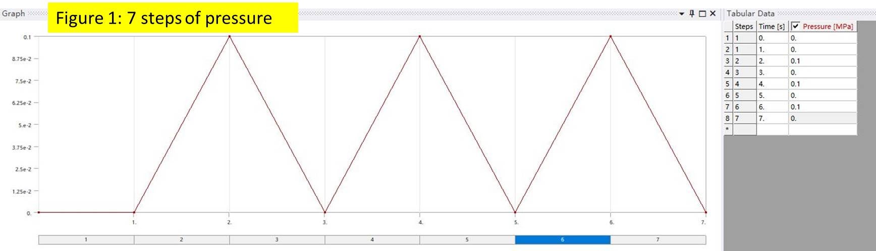

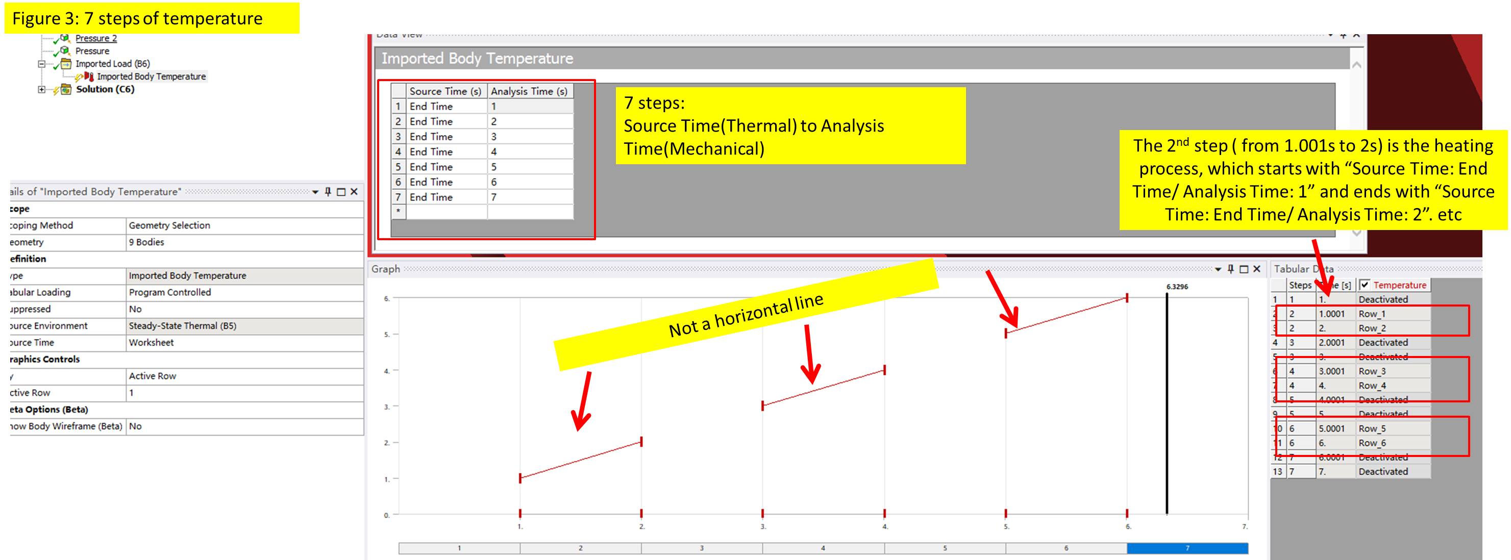

In fact, my Static Analysis has 7 steps. The 1st step is bolt-pretension. The 2nd, 4th and 6th steps are pressure loading and heating while the 3rd, 5th and 7th steps are unloading and cooling. See Figure 1 for pressure loading and unloading. The way of how I imported the temperature is shown in Figure 2 while your way is shown in Figure 3. The Data View, Graph, and Tabular Data show the big difference. The "Auto Time Stepping" is ON. The Initial Substeps, Minimum Substeps and Maximum Substeps are 10, 5, and 100, respectively. So the Time(s) in Tabular Data is shown as 1.0001, etc.

For the loads - it looks like the temperature is ramped for each active step. For element distortion please see if the following link is of help:
