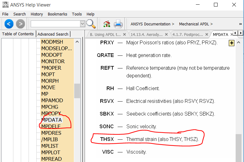

One thing you could try is to create a command object under the body in the tree whose additional thermal strain for -60 < TEMP < -80 is to be unchanged. In this command object you would delete the original thermal coefficient of expansion data (MPDELE,matid,alpx) then replace the TCE with equivalent values of temperature dependent thermal strain using the MPTEMP and MPDATA commands. The material property label for defining thermal strain is THSX (image below). Make the value of THSX the same for -80 C as it is for -60 C. Then calculated thermal strain should not change between these temperatures.
