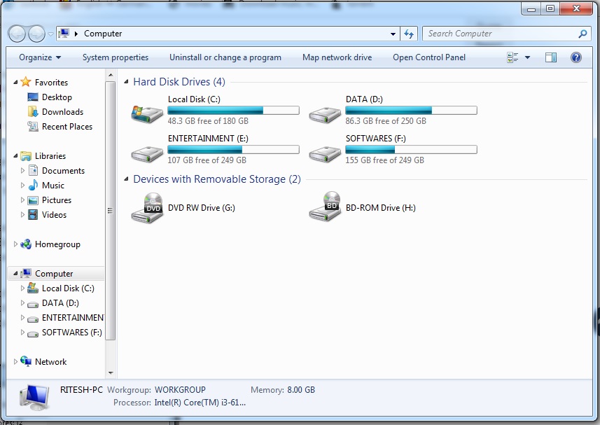

      Next, we have to work around the limited amount of RAM on the computer.  How many drives does it have and how much free space?  Please show the virtual memory settings.

      Please find the images of the things you asked for.
      Thank you.

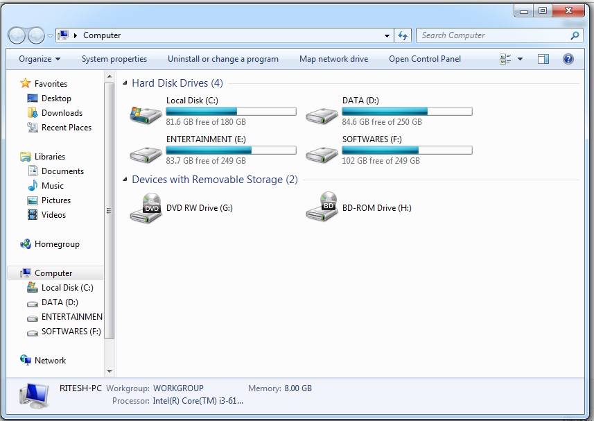

      Dear all,
      Sorry for the late reply.

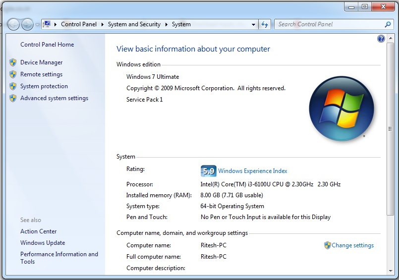

      I was trying to change some memory settings to get the results. But, now I am getting the insufficient memory error which I have mentioned at the end of the images.
      Please find the images of computer specifications. I have 8 GB RAM, 1 TB hard disk (divided in 4 drives) and 2 GB AMD Radeon graphics.
      Please suggest me the solution, if possible.
