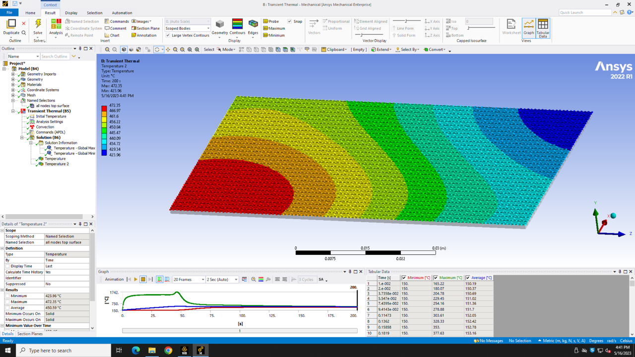

      How can we get the time-temperature data of each node for all time steps in doing welding simulation, simulataneously.
    • Aniket Chavan
      You can export results at different timepoint to excel and compile it there.
      -Aniket
    • Hreetabh Kishore
      But in my simulation at a plane there are 4000+ nodes. Is it possible to collect time temperature data collectively. Because, individually is not possible. Which option in settings could help me in getting all the nodes data. Can you please guide me.

    • Hreetabh Kishore
      Sir,
      The format i need is a column of time and a column of temperature for each node in an array. There is no specific format, i need. The matlab code will read text file of these collected data. I need not x,y,z data. Moreover, after decimal 3 digits are ok. Look on the below figure. Suppose I have selected 100 nodes. And I want time-temp data for each nodes of all time steps, 200 (provided during simulation). which means a total of 200 columns will be there. 100 for time and 100 for temperature. This is teh only requirement in the form of text file. But problem is I cannot select each node at a time to acquire the data. I want to get the data simultaneously for all at a time to get recorded.
      Thanks!
    • Matthew Middleton
      The Mechanical GUI does not have the predesigned ability to do this. Only a script could do this. Also, I’m not sure if you know that you can right click in a temperature result and export a tab delimited file of the temperatures at all selected nodes. But this is for one time point. You can change the evaluation time of the result and export all nodes again, and so work through all time points with this method. The other option is the time history that you see at the lower right. You can also export that if you first select the grey box at the upper left in the table, then right click to export. This reports, avg, max, min of the selected nodes. You have noticed that if you only select one node, that it evaluates to the exact value at that node for all time points, since avg,max,min are the same. This is what Mike Rife was stating. You can export all nodes at one time point or one node for all time points, but not all nodes for all time points. The GUI is not set up to do this. You could only do it with a script. Whether done as APDL script or Mechanical script is a matter of choice.
      Also your previous mention of 100 temperature columns and 100 time columns doesn't make sense to me. The temperatures occur at time points. You would have 200 temperature columns where each column represents a time point, plus one column for node ID, since you said you didn't need xyz location. The rows would be each node. In order to use the node ID's this would require you to export the exact mesh used in Mechanical and have that read into your Monte Carlo processing program. If you can't export/import the mesh, then you need 3 columns to represent the XYZ locations of each node.

    • Matthew Middleton
      Such a thing is certainly possible and compatible with Mechanical in workbench. It's just not a current feature, so needs to be done as a script in current version or ehancement request for a future version.
    • Hreetabh Kishore
      Yaa....Definitely.
      Thanks for the clarification. If possible can do help me in getting code for this so that I can open this model in APDL for such purpose.
    • Matthew Middleton
      We don’t normally write scripts for customers, but I was working on something similar recently so it didn’t take that much time for me to put something together as a derivative of what I was working on. Select the result object, and paste the script into the Mechancal script console. It will write a file to the user_files folder inside the project. It is a general script for multiple result types and analysis types. It has some error checking, but I didn’t rule out all invalid result types, especially for frequency based analysis:
