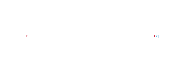

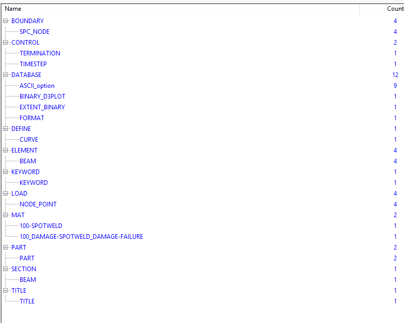

      I am trying a simple model of beams, and a damping effect is appearing although no visable card including damping is used. The beam is modelled wiht MAT_SPOTWELD.

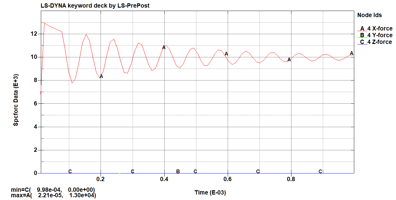

      This are the forces in the SPC at the start of the beam:
      How is the force reduced? Is due to artificial damping due to numerical reasons?

      Try mat01/elastic and elform=1 in beam section (no failure mat100card also) and see if that also gives this behav.
      (so just simple linear elastic beam)

      Hi
      I have verified this – must be some damping applied in the backgorund to this material/elform=9. I agree it is strange I must say.

      As we saw I can confirm that there is damping applied in the backgorund (can not be changed) to matspotweld.
      However This high frequency damping should not cause any problems.
