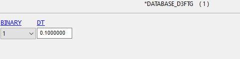

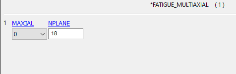

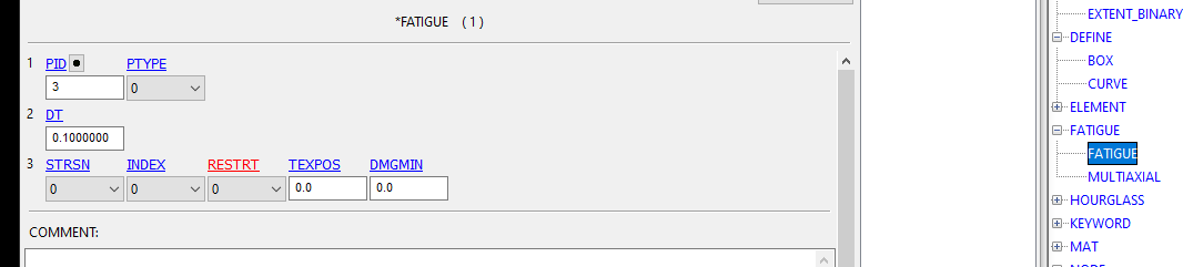

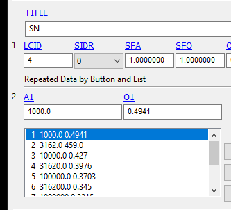

      Hi all.
      I'm simulating drilling.
      The stage of using fatigue has come.
      I used the following cards in my calculation:
      FATIGUE
      MULTIAXIAL_FATIGUE
      MAT_ADD_FATIGUE
      CURVE - SN
      DATABASE_D3FTG
      My problem is that the d3ftg file is not written, although I specified the write cycle:
      I set the cycle for recording d3plot to 0.1, and also for d3ftg. But after writing to d3plot, writing to d3fg does not occur, in addition, the calculation simply freezes to infinity, and if you look at the processor load, it is not there.
      WHY?

      In my lsdyna *frequency_domain_random_vibration analyses, I have to set MSTRES of keyword *CONTROL_IMPLICITE_EIGENVALUE to "1"... otherwise d3ftg is not written because the fatigue analysis depends on stresses. (see also LS-DYNA Manual  R13 Vol. I ; 22-56 Remarks 2.). This might also help in your case.
