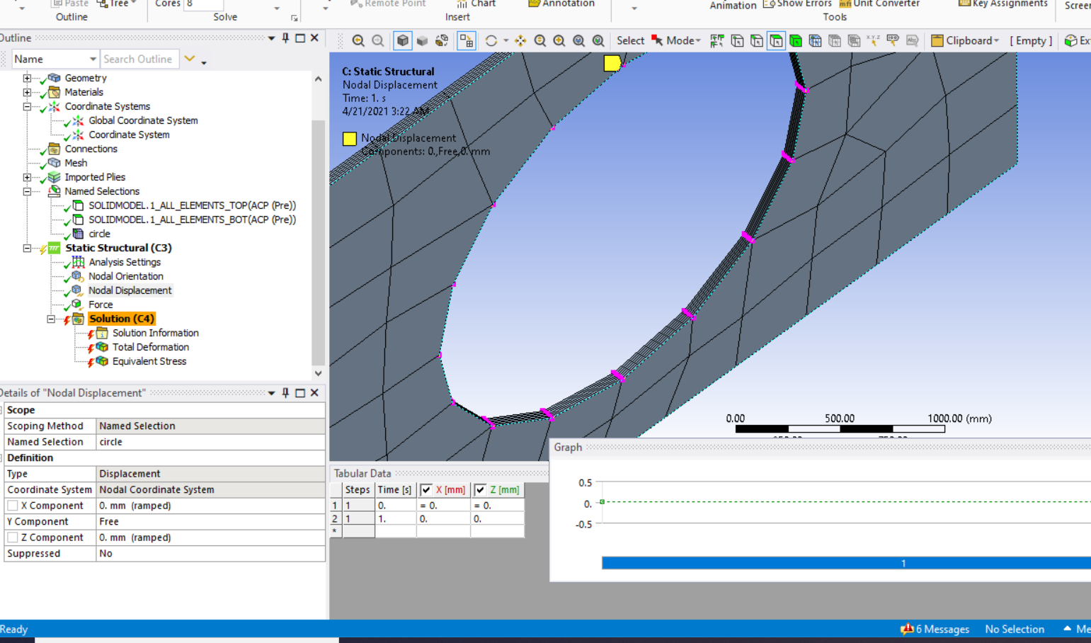

SubscribernIs this the correct setup for this type of part? I made a 5 ply composite plate with a hole that would have a bolt going through so it behaves like a tab. A force would be applied on the top face. For the solid geometry exported from ACP, I selected the node at each ply, so there were a few going across and then around the circle. I didn't try the shell geometry yet. For the nodal displacement, I fixed it in the x and z direction of the cylindrical support to imitate tangential and axial constraints. However, it was not able to solve. n

April 21, 2021 at 12:43 pm1shan
Ansys Employee,nWhat errors do you get?nIshan. nApril 21, 2021 at 3:11 pmSam1
SubscribernI've had a combination of these errors:nSolver pivot warnings or errors have been encountered during the solution. This is usually a result of an ill conditioned matrix possibly due to unreasonable material properties, an under constrained model, or contact related issues. Check results carefully.nA solver pivot warning or error has been detected in the UY degree of freedom of node 718 located in SolidModel.1. This is usually a result of an ill conditioned matrix possibly due to unreasonable material properties, an under constrained model, or contact related issues. Check results carefully. You may select the offending object and/or geometry via RMB on this warning in the Messages window.nNot enough constraints appear to be applied to prevent rigid body motion. This may lead to solution warnings or errors. Check results carefully.nnIn real life, these pieces are like tabs on a composite piece experiencing loading and the bolts go through the tabs to mount on another piece.nApril 22, 2021 at 4:31 am1shan
Ansys Employee,nI see that you have a free rotation DOF (along y) right? This will likely case the plate to rotate, when a force is applied, which is likely the reason for pivotal error. When you have a bolt going through a washer, it exerts pressure on the surface of bolt and the resulting friction force between washer and mating surface prevents it for rotating, right? Since you have not considered the friction force here you have to provide an additional constraint to the washer. Either fix the Y rotation (which will be equivalent to a fixed support) or give zero displacements ( free only the normal to plate direction) to the sides .nRegards,nIshan.nViewing 7 reply threads- The topic ‘Cylindrical Support in ANSYS ACP’ is closed to new replies.
