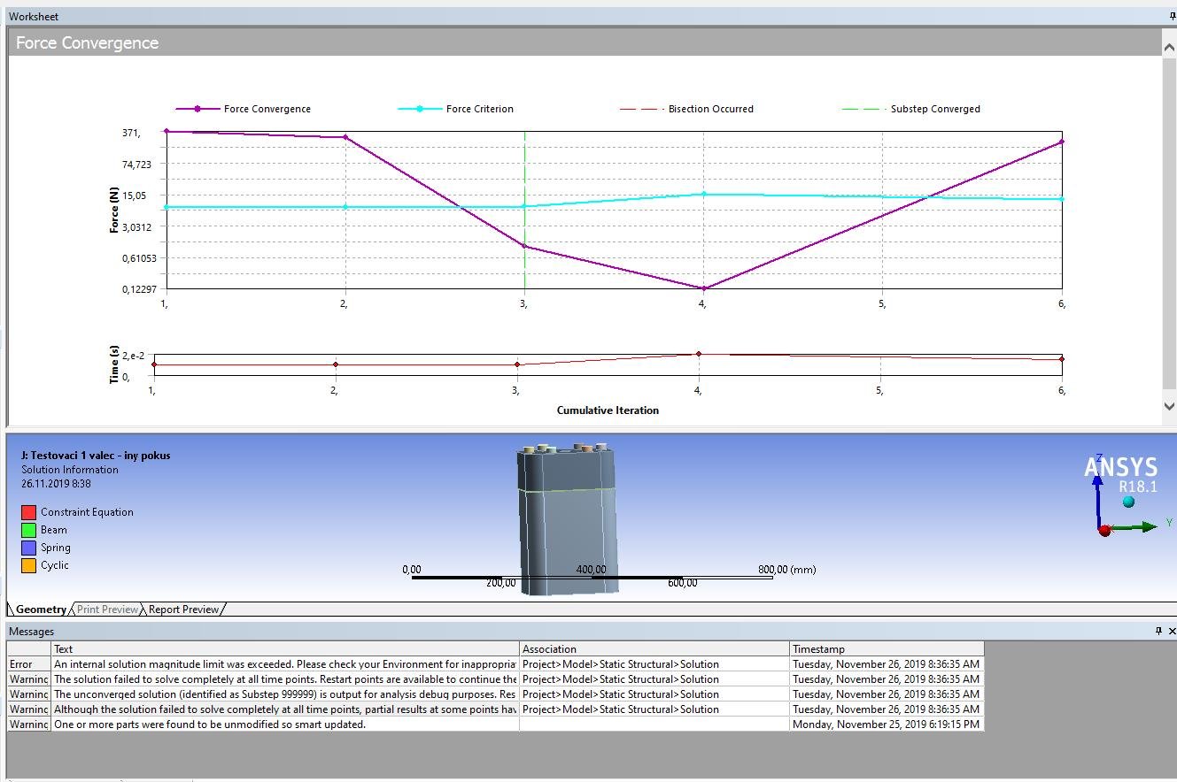

      I think the error was "An internal solution magnitude limit was exceeded. Please check your Environment for inappropriate load values or insufficient supports.  Please see the Troubleshooting section of the Help System for more information."
      Here is the plot.
      Thanks
      Under Analysis Settings, turn on Auto Time Stepping.  Set the Initial Substeps to 100 and the Maximum Substeps to 200.  Will that allow it to converge?
      If not, change all Bolt Pretensions from Load to Adjustment. Then in the Preadjustment field, type in the 0.3 mm or what ever gap closure you want from the initial CAD gap of the gasket thickness. That will not cause a problem with solution magnitude limit exceeded error.
      If that converges, look at the Load in the Bolt. That will tell you if you have a mistake in your gasket material model. For example, it is not generating the correct compressive force.

      Neither substep or preadjustment settings helped with convergention. In both runs, the error message of internal solution magnitude comes up. Here are the force convergence plots.
      First run: substep settings + pretension in Newton
      Second run: substep settings + pretension via preadjustment in mm (0,2 mm value)
      Please note that I am trying the simulations on very simplified 1-cylinder model, just to verify convergence.

      You understand preadjustment perfectly. The benefit for convergence is if you have no stiffness in the gasket and apply a pretension force load, then the head can move meters.  With the same improper gasket stiffness and an adjustment, the head can only move 0.2 mm.
      If you have frictional contact between the bolt head and the cylinder head, change that to bonded. I assume the thread end of the bolt is bonded to the holes in the block and try again with the preadjustment on the bolt.
      You can also File, Archive and create a .wbpz file and attach that after you post a reply so I can take a closer look.

      UPDATE: I figured it out. Now the analysis solves in a fraction of time and it works reliably even with force as bolt preload. What i needed to change, besides your advices, was (in all contacts):
      Update stifness - each iteration,
      Detection method - Nodal-normal to target
      Now lets try frictional contacts.
