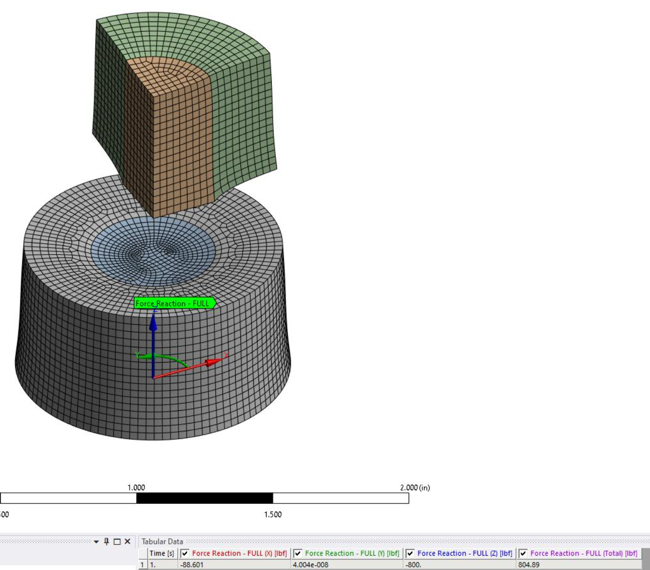

      I have a model static structural model,  press fit.  Using cyclic symmetry with 8 sectors.  Is the Force reactiion the total force for all 8 sectors or do i need to multiply the output value x 8 sectors.

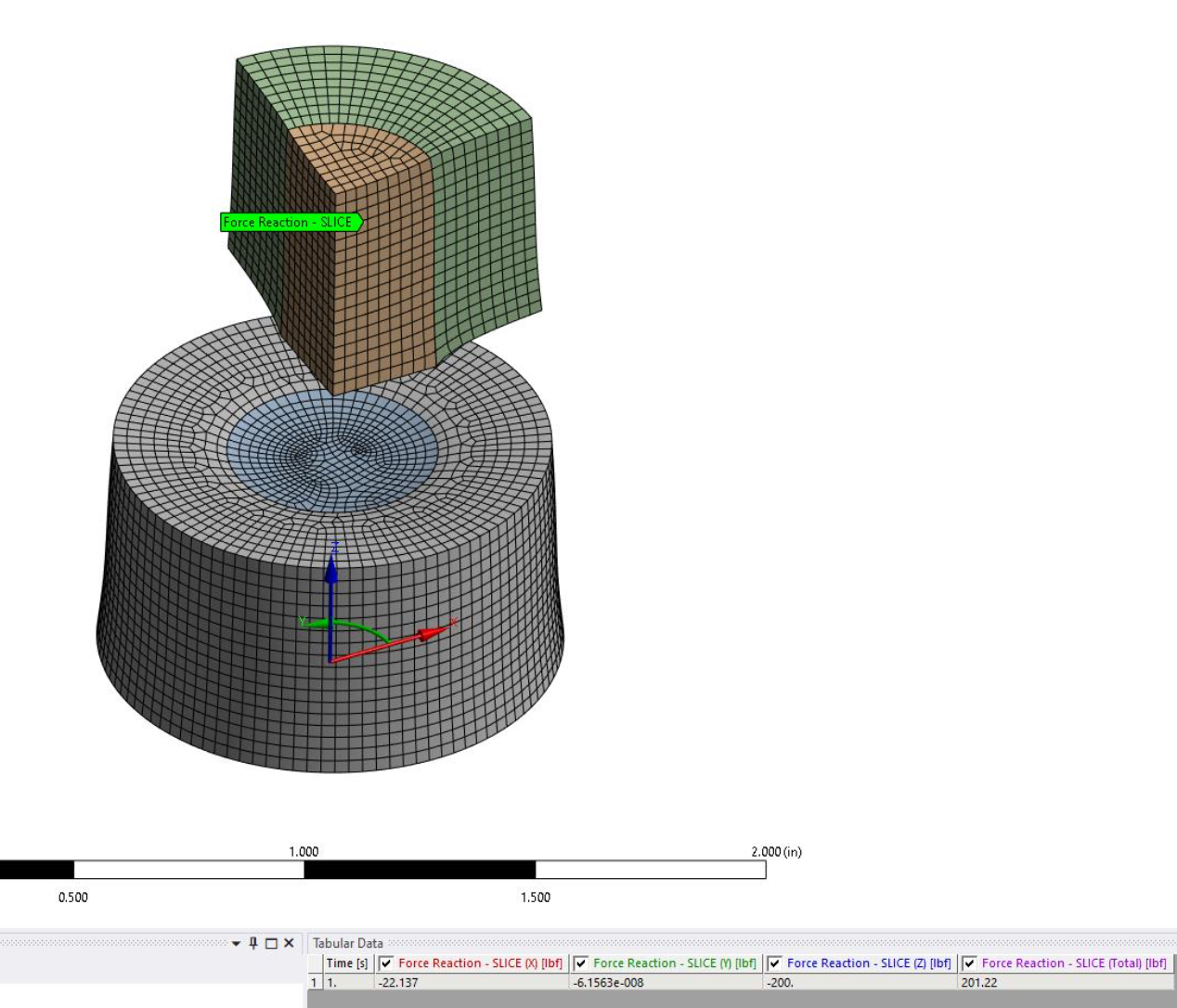

      I made a small breakout model and came to these conclusions:
      For reaction forces  (fixed etc)  the model returns the total based on the # of sectors
      For contact forces, the model only returns the load from 1 sector regardles of the display settings or # of sectors
