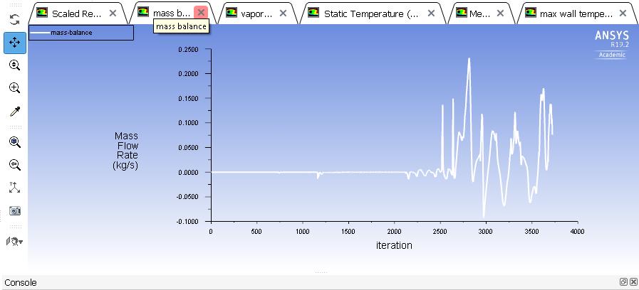

      Hello everyone,
      I am currently working on simulating the critical heat flux phenomena in FLUENT and am using experimental data from Celata et al. The geometry is a 2.5 mm ID pipe with 100 mm of pipe followed by 100 mm of heated pipe. I'm modeling a case run at 2.5 MPa pressure using the 2D axisymmetric condition with a rectangular geometry of 1.25 mm in width and 200 mm in length. The mesh has 20 radial divisions and 500 axial divisions.
      For the FLUENT conditions, I am using:
      Gravity On in the -x direction
      Multiphase -> Eulerian -> Boiling Model -> Critical Heat Flux
      Energy On
      Realizable k-epsilon model with standard wall functions and Mixture turbulence multiphase model
      Phase Interactions:
         Virtual mass -> constant -> 0.5
         Drag model -> Ishii
         Lift model -> Moraga
         Wall lubrication model -> Antal et al.
         Turbulent dispersion force -> lopez-de-bertodano
         Turbulence interaction -> Troshko-Hassan
         Heat transfer -> Ranz-Marshall
         Mass transfer -> Boiling from Liquid to Vapor at 497.1 K saturated temperature
            Bubble departure diameter -> Tolubinski-Kostanchuk
            Frequency of bubble departure -> Cole
            Nucleation site density -> Lemmert-Chawla
            Area influence coefficient -> Delvalle-Kenning
            Surface tension -> Constant -> 0.032148 N/m
            Interfacial area -> particle
      To get inlet velocity, k, and epsilon profiles, I first ran the model with no heating and vapor generation and exported the outlet profiles to be read for the inlet profiles. The outlet profile was specified using 1% turbulent intensity and 0.0025 hydraulic diameter. In addition, the backflow temperatures of the liquid and vapor were set to the saturation temperature.
      For a solver, a Coupled -> Pseudo-transient set up was used. The explicit relaxation factors were not adjusted while the timescale factor was adjusted to 0.1.
      As a model for departure from nucleate boiling, I increased the heated wall heat flux from a heat flux where convergence was achieved up to the critical heat flux, which is about 27 MW/m^2 in this case. I think that to see if CHF has occurred, a large jump in maximum wall temperature (which I recorded in the model as the vertex maximum liquid static temperature at the wall) should be seen after applying a higher heat flux value. However, I've seen in previous work that the model achieves convergence after this jump in wall temperature and I am not getting the same type of convergence at higher temperatures when a very high heat flux has been applied.
      Does anybody know how to achieve convergence for this CHF modeling?
      Any help that can be provided is very much appreciated!
    • DrAmine
      First of all avoid having mesh with Yplus small than 30. Remove all inter-facial forces just keep Drag (Universal) and Dispersion Force (Burns). Coupled pseudo transient is good. Consider later on adjusting all sub model parameters to reflect your material.
      Convergence can be in fact very hard to achieve here.
