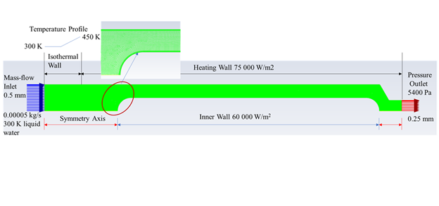

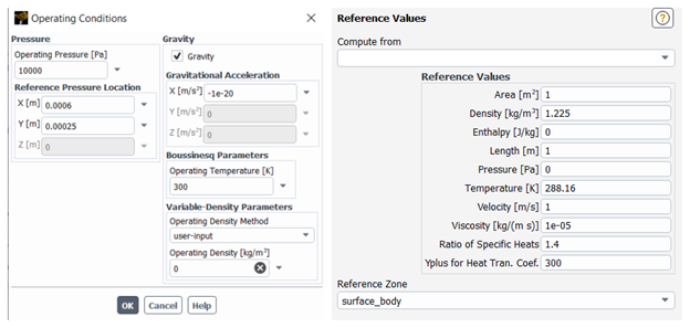

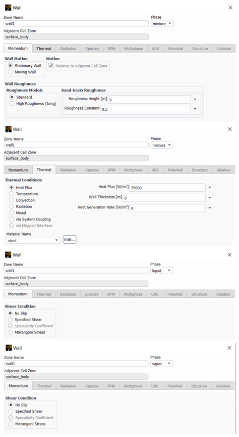

      I am currently simulating water boiling in a micro tube with low pressure and microgravity.  The inlet radius is 0.5 mm, the near inlet part was set to isotherm wall, followed by > 6mm heating walls. The axial length is about 7 mm, the outlet radius is 0.25 mm.  I ran the case at 10 kPa pressure, -1e-20 m/s2 gravity in X-direction (I’d like to set it to zero, but the boiling model requires it to calculate some parameters like bubble departure diameter), using the 2D axisymmetric condition. The mesh has a structured grid of about 25400 cells and a focused inflation layer in the wall surfaces, I estimated the y plus is about 50. The heat flux of outer and inner walls was set to 75 000 W/m2 and 60 000 W/m2 respectively, it’s supposed to be enough to evaporate all the low mass-flow liquid, so I chose the Critical Heat Flux wall boing model.

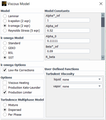

      SST k-ω model with Low-Re Correction

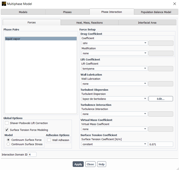

      Phase Interactions:
      Forces (I tried just keep Drag (Universal) and Dispersion Force (Burns) because of some ANSYS staff’s answers from this Forum, but it didn’t work)
      Drag model -> Ishii
      Lift model -> Moraga or tomiyama
      Turbulent dispersion force -> lopez-de-bertodano
      Surface tension -> Constant -> 0.071 N/m or 0.032 N/m
      Heat transfer -> ranz-marshall

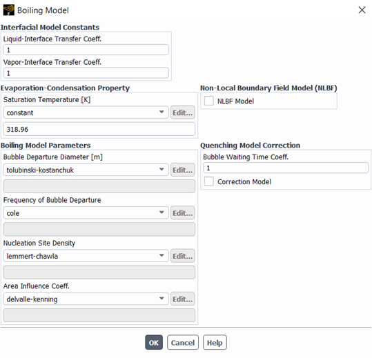

      Mass transfer -> Boiling from Liquid to Vapor at 318.96 K saturated temperature (10 KPa)
      Bubble departure diameter -> Tolubinski-Kostanchuk
      Frequency of bubble departure -> Cole
      Nucleation site density -> Lemmert-Chawla
      Area influence coefficient -> Delvalle-Kenning
      Interfacial area -> ia-particle

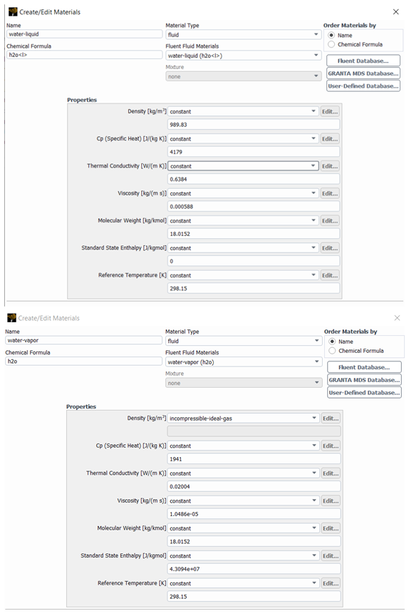

      I defined the fluid properties referring to the water properties corresponding to 10 KPa. I kept the reference temperature by default here, I’m not sure of the exact value I should input.

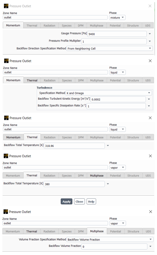

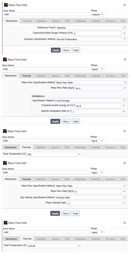

      Since I set up this case based on replacing mesh into CHF boiling tutorial VMFL067_FLUENT-1 and modifying boundary conditions, some inlet and outlet profiles like inlet k and ω, outlet k and ω, the outlet backflow temperatures were set by default or in line with the tutorial case. In addition, the inlet mass flow rate is 0.00005 kg/s and outlet gauge pressure is 5400 Pa.

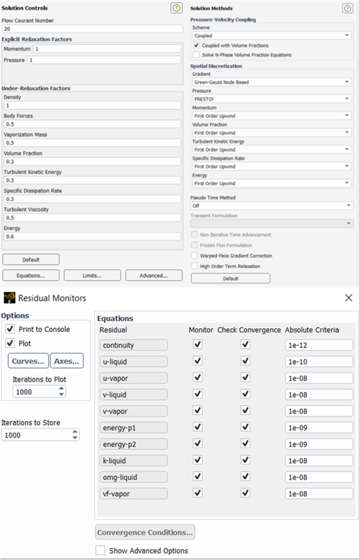

      For a solver, I tried Coupled with and without Pseudo time, but both eventually got crushed. I also tried a transient solver.

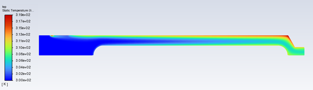

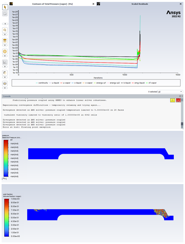

      I increased the heating wall heat flux from 10 000 W/m2 gradually, there was no vapor generation with relatively low heat flux. After the heat flux increased to 75 000 W/m2, it seemed OK before the fluid reached the saturation temperature; With further iterations, the mode would diverge, resulting in the discontinuous vapor phase and invalid pressure contours. However, I've seen in previous work that the model achieves convergence but I am not getting the same type of convergence when this high heat flux has been applied.
      After liquid water reached saturation temperature

      By the way, it would be good if anyone can explain the reference temperature when defining the fluid properties and inlet/outlet turbulence profiles further.

        Yes, it diverged with fewer irritations when I set default g, so I gradually decreased the magnitude of |g| until e-20 (I also tried to set g as zero),  the only difference is that the case would have more iterations before the divergence.
        After posting this, I tried only doing a single change in the tutorial case VMFL-067-FLUENT-1. As I changed the density of liquid water or the specific heat of vapor water, the tutorial case just diverged. So I also would like to know if the CHF wall boiling mode is sensitive to the material properties, and the applicability to the low operating pressure. Thank you so much.

      Yes, it is recommended to use temperature dependent properties with pressure dependent saturation (pt-sat or ptl-sat) or even better, real gas property (RGP) tables with saturation tables.
      But using constant properties won't lead to sudden divergence like this. Can you check your y+? Boiling models won't work with low y+ and it is better to maintain y+ greater than 15 or so for stability.

      I have the 22R2 verification cases with me. The y+ for both phases is more than 20 in them. And you can't really play with that setup by changing the density and specific heat values. That affects the LH heat calculation. Also the saturation temp is set as constant in that setup. Incompatible values can cause that. They are indeed fine tuned to match literature.
      Can you try without lowRe model?

        Sorry for the late reply. I need to confirm whether having lowRe model disabled has a big impact. I remember I used to disable the lowRe model in the previous case, but at that time I used fixed temperature wall boundary conditions, although some former cases didn't crush, there was no vapor generation even with a very high wall temperature. Later I changed to simulate it with heat flux wall boundary conditions as this post shows.
        Unfortunately, I just tried the current case without lowRe model, and it ran for more irritations but still diverged. I looked through all threads about boiling in our ANSYS forum, tried most of the general suggestions like ensure enough y+, keep only more important interphase forces first, etc. but it didn't work for my case. So I wonder about the applicability of the CHF boiling model.
