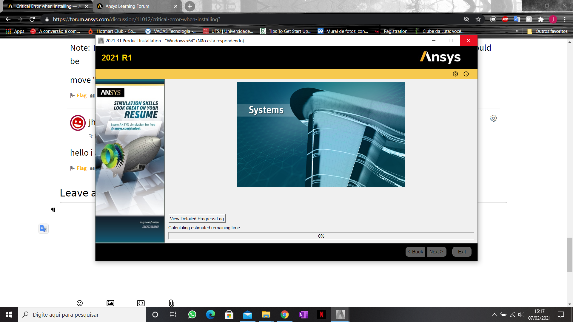

    • jhon_elder
      hello i am having same problem with installation.I am trying to install 2021r1
    • jhon_elder
    • marcos
      Look, I dont know what I did, but what appears to have worked for me is...:
      Before it crashed, I clicked on “view detailed progress log”.
      that prevented the crash. But an error window still appeared. I clicked “ok” and the installation magiacally began. It didnt worked the first time though, because the same error window appeared almost at the end of the installation process and crashed it all. The next time I repeated what I did, but decided to leave alone the computer untill it finished. And... seems to have worked

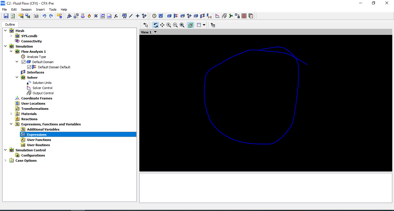

      Hola tengo un problema a la hora de editar ( Setup) Ansys la pantalla se muestra oscuro alguien sabe como solucionarlo muchas gracias de antemano
    • Zuhdi Alias
      I was facing the same problem. It really helpful if anyone can give the instruction to this problem
    • Laura Valeria Ladino Mantilla
      I have the same problems do you find any solution?
