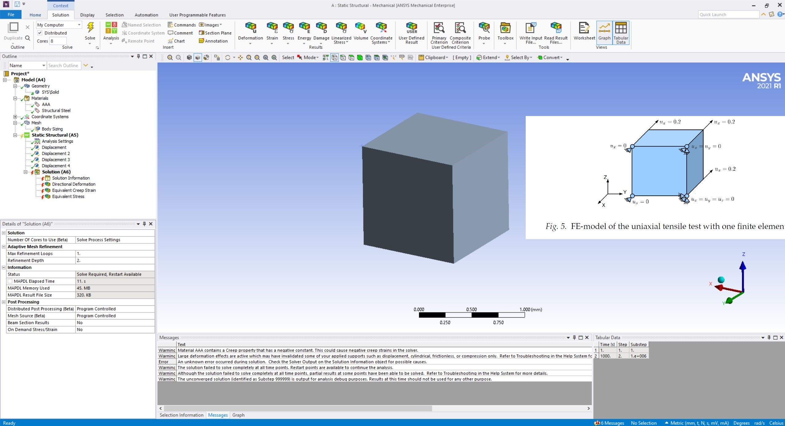

      • I tried to validate the creep model with 1 cube/element as in the video, but the analysis doesn't converge (see picture).
      My question is: in my case I have a constant pressure against the plate, but the stress field of the plate is not constant, because we have bending. In this case, the solutor takes which value of stress to calculate creep? The maximum one?
      The creep strain and the plastic strain are calculated on an element-by-element basis during each substep. These strains accumulate over the duration of the simulation.
      To help convergence, break the time into more steps. Step 1 is with time integration off to apply the load, but instead of 1000 seconds for step 2, make step 2 end at 2 seconds, make step 3 end at 10 seconds, make step 4 end at 100 seconds, and step 5 end at 1000 seconds. That should help the solver to converge.
      You might also reduce the size of the applied displacement from 0.2 to 0.02 mm if the above still fails to converge.

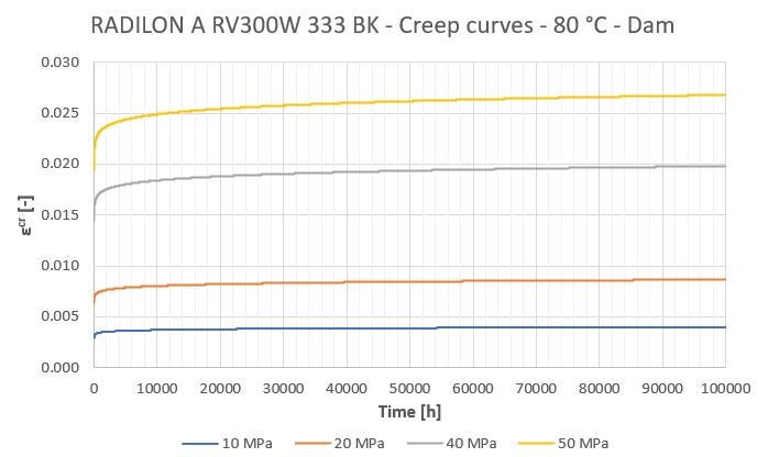

      • Jacopo Bardiani
        Attached you see my experimental curves and the Modified Strain Hardening creep model with the previous constants really matches all this curves.
        I'm a bit confused why ANSYS doesn't provide the proper value of creep strain.

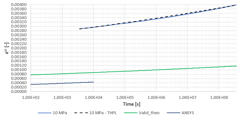

      Fitting constants to highly nonlinear functions is an art-form and can seem to converge, but on incorrect constants. That is why it is important to validate the model. When plotting creep strain, use a log scale for the Time axis, that will take some of the nonlinearity out of the data.
      What is the Normal X Stress in the unit cube?  Plot the creep strain from the unit cube over the experimental creep curves.

      Hi Peter,
      attached you see the comparison! Green: trend of the creep strain through the Modified Time Hardening Power Law, "ANSYS" curve is the results of ANSYS creep strain (I did an analysis with 1000 seconds). These curves are referred to a simple model (rod in traction).
      The curves above are the experimental creep curves of the material, with the analytical formula (dashed).

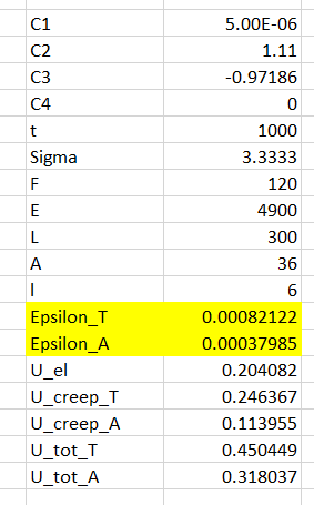

      The features of the rod for validation are the following (units mm, MPa, s, etc):
      What do you think? Really weird...

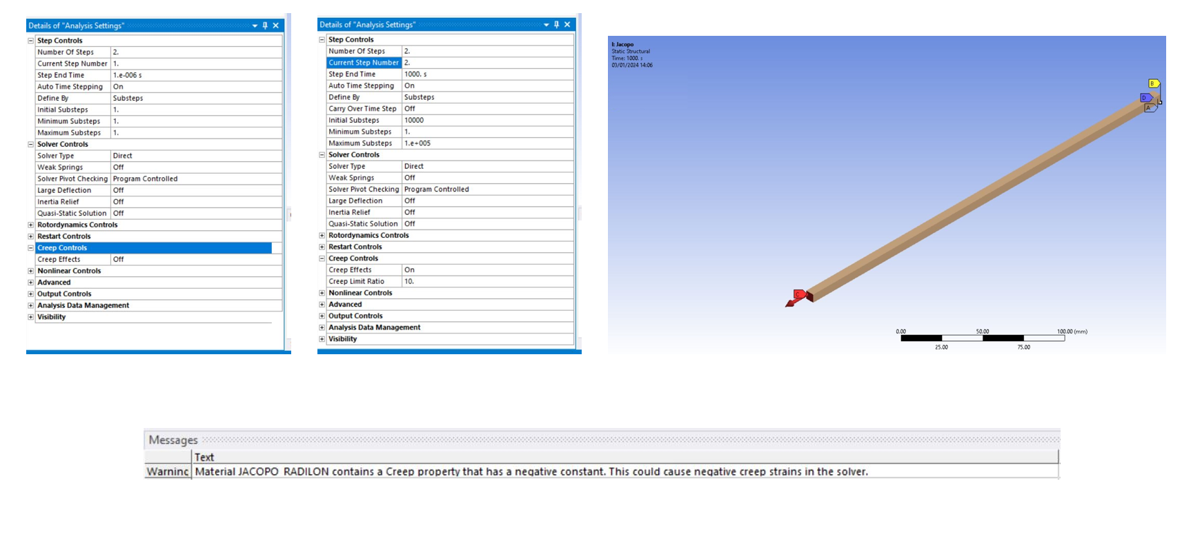

      Please show time step details of Step 1 and Step 2 for the Ansys analysis of the simple rod in tension. How many seconds is in step 1 when the load is ramped on?  Is Creep turned off during step 1?  That could be the source of the discrepancy.
    • Jacopo Bardiani
      Attached you see some pictures...I took this example from a model made by ANSYS developers (with creep in an aluminium rod) and I inserted my value...In their case, all results are perfect...
      I see a mistake in the Analysis Settings for creep in the simple rod: you must set Large Deflection to On.

      I always see the warning about C3 that is negative, that case can cause problem like this mismatch?
      I have no other ideas: the example of the ansys developers with the same rod, different material and constants reallt matches the theoretical formula.
      The warning is about negative creep strains, but since C3 is in the equation as C3+1 and since C3 is -.97, that means C3+1 is still positive, so I would guess that you would not get negative creep strains.
