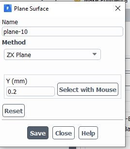

I am trying to create a new plane using Method "ZX Plane" in the Fluent Solution, not the Results. After selecting the Y value (e.g., 0.1mm) and creating the plane, it retrieves the default value (e.g., 0.2mm). I am not able to save the new Y value for the plane surface. I have tried the same for other Fluent models, and the same issue exists.

Ansys EmployeeIs it possible to create an iso-surface with y = 0.2 mm?

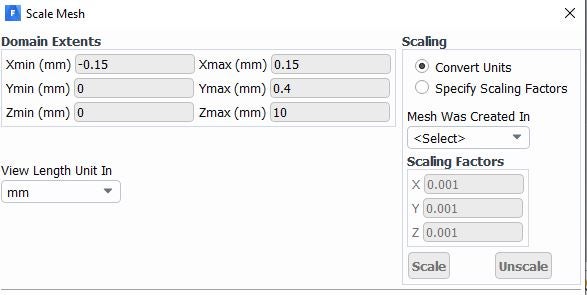

Forum ModeratorCan you go to the Domain tab and post the Scale panel?

SubscriberThank You very much. But I am wondering why the basic method of creating XZ surface plane is not saving the input value (Y).
May 11, 2021 at 8:42 amRob
Forum ModeratorNot sure, planes have always been a little temperamental which is why most staff use iso-surfaces and we advise that as part of the training too.
