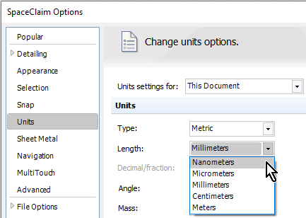

SubscriberIn Spaceclaim, you must change the Units before you start to create any geometry to shift the geometry engine to the smaller domain. This dialog box is found under the File menu.
After you have created some geometry, the smaller domains will not appear in the drop down list.

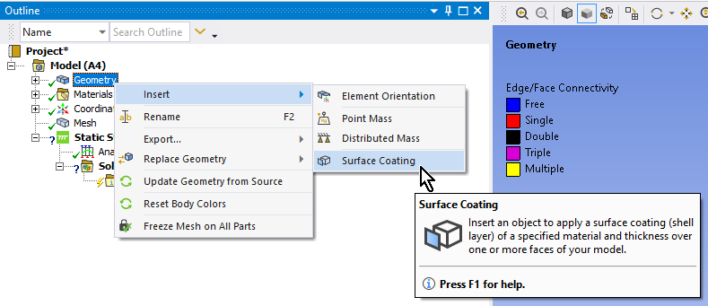

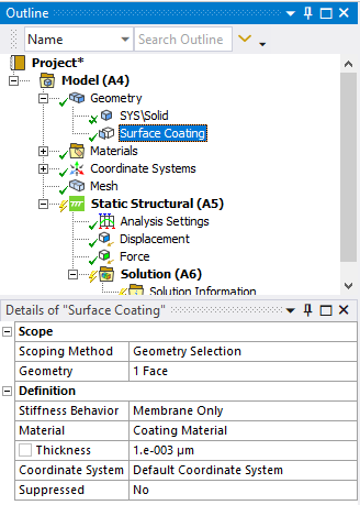

Consider using a Surface Coating to represent the 10 nm thick layer on the surface of the 400-micrometer box.
In the image below, I choose Micrometers from the list above and have defined a 1 nm coating.
By using a surface coating, there is no need to create a thin layer of uniform thickness geometry to mesh with solid elements. Surface coating will apply the material at the correct thickness to one ore more faces of the solid body.

SubscriberThe surface coating in Mechanical is simply some automation to reduce the labor in creating shell elements on the surface of solid elements. You can mesh a surface and mesh a solid and use Mesh controls to get the identical nodes on the surface and the face of the solid, then do a Mesh Merge to have the shell and solid elements share the same set of nodes. Shared topology may also work.
What kind of analysis do you want to do that requires Explicit Dynamics? The microscopic size of this geometry will cause very long solution times in Explicit Dynamics. There is no solution time penalty for microscopic size geometry in Transient Dynamics or Static Structural analysis.

SubscriberI am using the latest version of ANSYS 2021 R2. The surface coating feature was only released in the last year or two. You won't see that on older versions.
You won't want shell elements if you are doing surface coating damage from particle impact, you will want solid elements.
