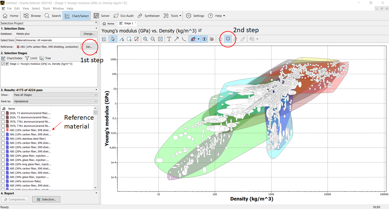

I would like to create an Ashby material chart (Young's modulus vs density) with the material families and a new set of materials in the chart. Right now I have created the plot with my materials and the material families however it still shows the materials I would like not to show in the graph as white area's. Is there a way to remove those and only show the material families and the bubbles for my materials?
Thanks,Chris
December 11, 2023 at 1:33 pm
David Mercier
Ansys EmployeeHi, there are multiple solutions for that.
1) You set up a reference materials and use the "Highlight reference record" button to highlight your reference material:

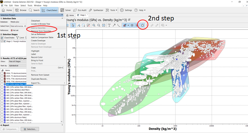

2) Do the same but with the 'Favorite' concept...

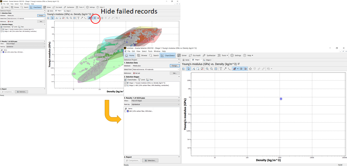

3) Use a criteria to filter the materials and to keep only those you want, or you set the tree to select only the material you want to keep and use the 'Hide failed records' in the plot options toolbar, to hide failed records.
