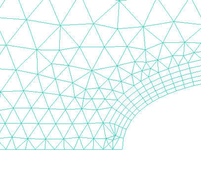

SubscriberHey guys, I have a geometry that models fluid moving past a sphere. I am going to only model half the pellet, assuming symmetry of flow. I want to create a mesh similar to the picture below, where quadrilateral cells are used in the regions surrounding the pellets and triangular cells for the rest of the domain. This picture is from a Fluent tutorial for periodic flow.Â
I am a bit fuzzy on how to create hybrid meshes like the one above. In my simulation, the fluid is represented as one cell zone, with no divisions.Â
If anyone could point me to any resources about how to create this kind of hybrid mesh or any tips, I would really appreciate it.Â

SubscriberSorry, recently solved.
Just had to apply inflation to the cell zone and select the boundary of the circle for the inflation layer. Then used an all-triangle method for the cell zone.Â

Forum ModeratorThat'll do it. If you're in 2019Rx have a look at the new Watertight Geometry workflow: that'll give you poly elements so likely to be more accurate.Â

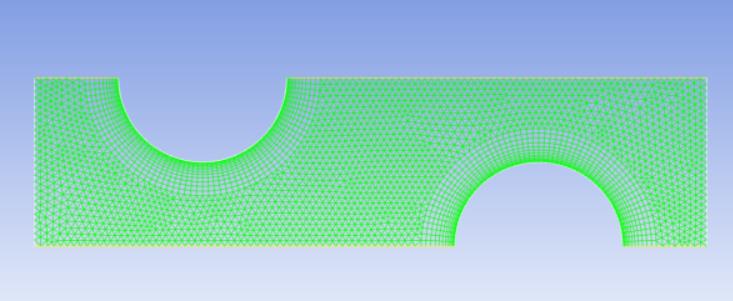

SubscriberHi I have a problem with prism layer at leading and trailing edge (see the picture). It's a 2D axissymetric domain with symetry at the bottom. Please, how it be fixed? Thanks -

darna darna
SubscriberICEM
