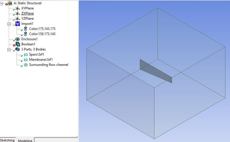

      I am trying to use a boolean to subtract the wing from an enclosure. However this fails due to the model having 0 volume due to being 2D.
      Adding thickness to mesh worked well for static structural. However I now wish to analyse flow over the wing and couple fluent with transient structural to view the pressure distribution on the wing surface.
      Any help or suggestions would be great thanks.

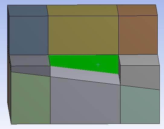

      It is possible to analyze fluid flow around a zero thickness surface, you just need to slice the air at the plane of the wing and on each of the four edges so the interfaces can be marked as "wall" where there is a wing or "interior" where air is touching air.
      After you slice the air solid using those 5 planes in SpaceClaim, use the Share button on the Workbench tab to mark the 18 pieces with Shared Topology. If any Contacts are created automatically in the Meshing program, delete them. Shared Topology will connect the mesh.  Use Named Selections on the faces to name the "wall" and "interior" faces, as well as "inlet" and "outlet".  You might find the Explode feature to be useful to spread out the 18 pieces.

      Okay I am attempting this currently, I am losing the membrane geometry when opening mechanical.
      I only have the thick beam and the created solid bodies. Why is this?
      Also where can I find the exploded view option?
      I have attached my file.
      The membrane is just a face of one of the solids.
      I see that the Spar part is imprinted on these solids. For Structural models, a surface body for the thick spars worked well because you could assign a thickness to the spar to represent its stiffness. But for Fluent models, the thickness of the spar has to be physically present to carve out that volume of air to create flow around the thickness of the spar.
      You could either go forward with what you have and ignore the spar thickness in the fluid flow, so it will be an approximation, but it will be simple to set up a structured mesh, or you have to go back to CAD and add planes on every surface of the solid spar and end up with something on the order of 100 small pieces.
      Or you could do an unstructured mesh on a single air volume.
      Here is the Explode function, but it doesn't work for the solids in multibody parts, it only works for assemblies with multiple parts (components in SC).
