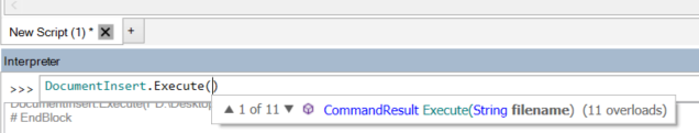

    • Aniket
      If you check DocumentInsert.Execute command in the interpreter:
      It can also be used as follows:
      DocumentInsert.Execute(r"D:\Desktop\Desktop\test1.txt")
      Now you can use other modules to get all files in a directory and import them in a for loop if you want the geometries in a single file. If you want them in different files, then you can simply use save as before importing new text file each time:
      # Save File
      options = ExportOptions.Create()
      DocumentSave.Execute(r"D:\Desktop\Desktop\test3.scdoc", options)
      # EndBlock
