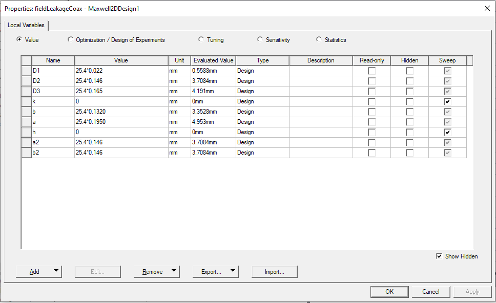

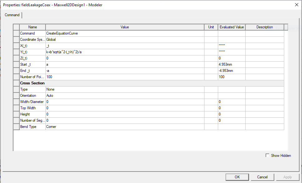

      I am trying to create a parametric ellipse using the draw\equation based curve along with some defined project variables. I want to simulate deforming/squishing a coaxial cable, and how it could lead to leakage fields. I keep getting the following error when I modify the variables used to define the ellipse equation or sometimes when I try to increase the number of points:
      "Body could not be created for part EquationCurve1 because of invalid parameters of this part or some of its parent part/coordinate system."

      Fig. 1.  Equation for ellipse upper branch, Lower branch is similar.
      Fig. 2.  Defined project variables.

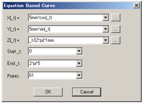

    • Takeshi Itadani
      When setting up an Equation-Based Curve and using constants in variables, you must always include units. Please ensure that all necessary units are included.
