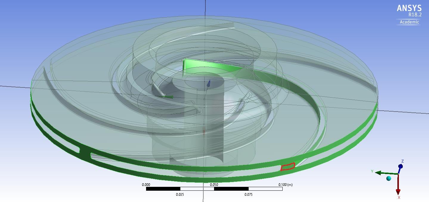

      I would like to recreate a pump geometry in BladeModeler. I have found a few YouTube videos doing this using the CAD import feature in DesignModeler. However, these videos start with a flow path which is much easier to extract the hub and shroud curves from. In this case, I do not have a flow path to begin with, and so I would like to create one. The issue is the geometry has some blade cuts that cut the hub and shroud surfaces.
      How do I to connect the cut edges such that I can create a hub and shroud contour for exporting to BladeModeler? I have attached the IGES file of the pump if that makes it any easier to understand my issue.

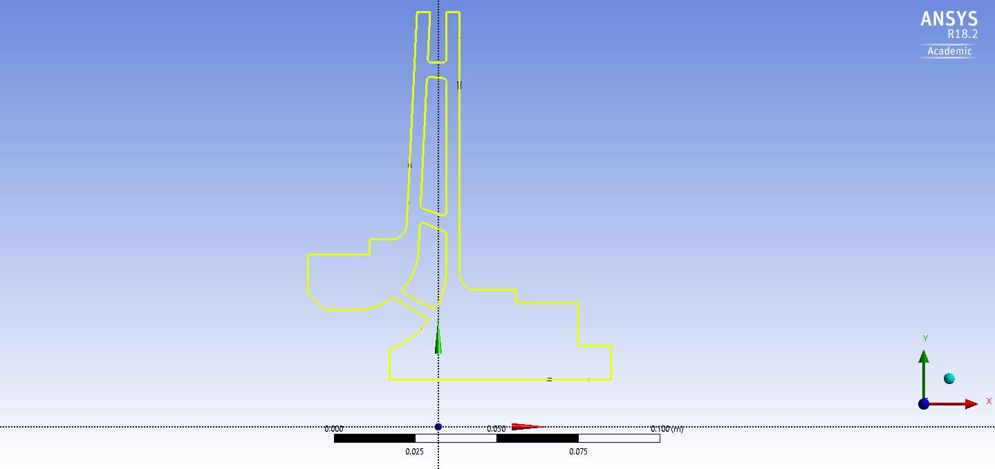

    • jamesgr
      For example, I can create a group of line bodies created from a sketch projection of the required slice.
      But these are grouped as 3 distinct line bodies, rather than the 48 edges it contains.
      I would like this to be listed as the 48 edges instead. Also, I need a way of creating the missing lines that define the hub and shroud curves.

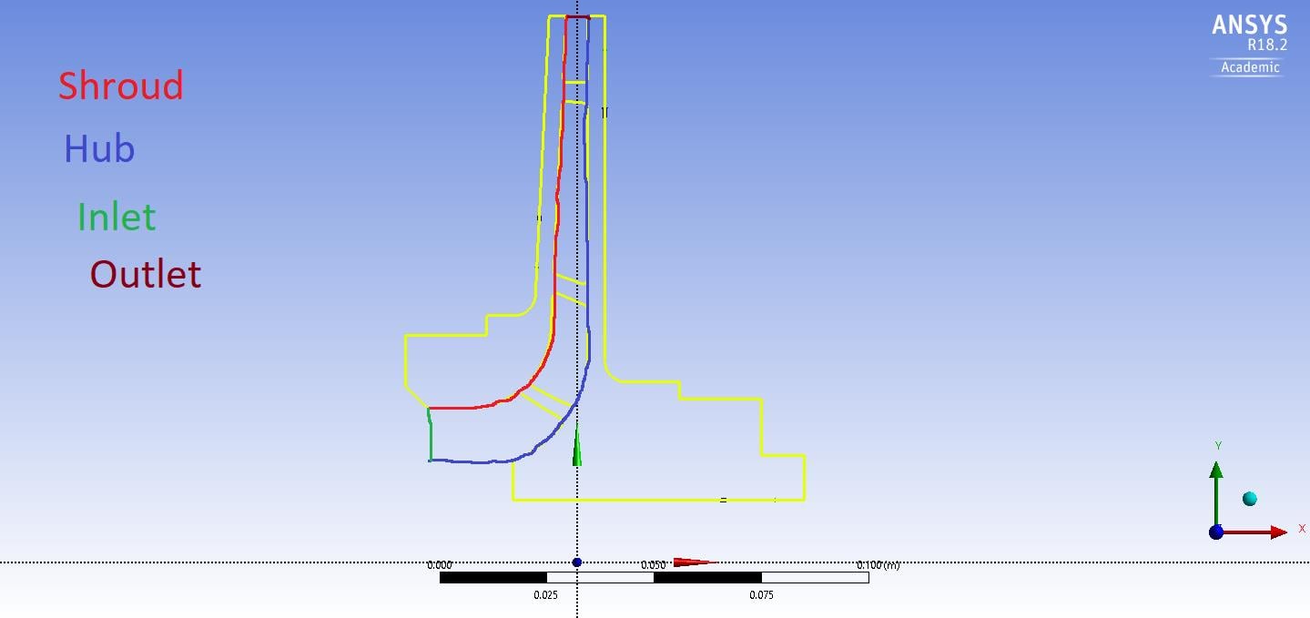

      In essence, I would like to create the following curves:
      In order to do this, my thought process is to extract all of the 48 edges from the "line bodies" and then create the missing curves using a curve which matches tangents at both endpoints. Then I can simply define the 4 required curves by grouping necessary curves/lines together.

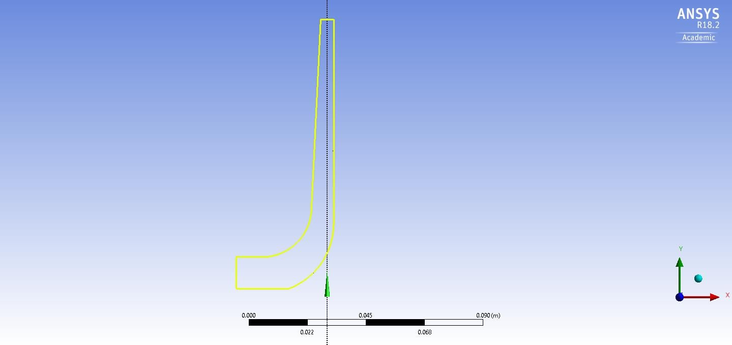

    • jamesgr
      So I managed to create the flow path by deleting a number of the edges, converting the required edges to a sketch, sketching the required lines using arc from tangents, reverting back to a line, and then deleting the unnecessary lines.
